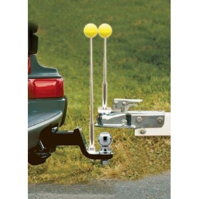

I think it's a great idea especially as you said in light of the very generic Forest River manual. I've got one for hitching/coupling gadgets. thttp://www.rpod-owners.com/uploads/618/Hitch_Alignment.jpg
