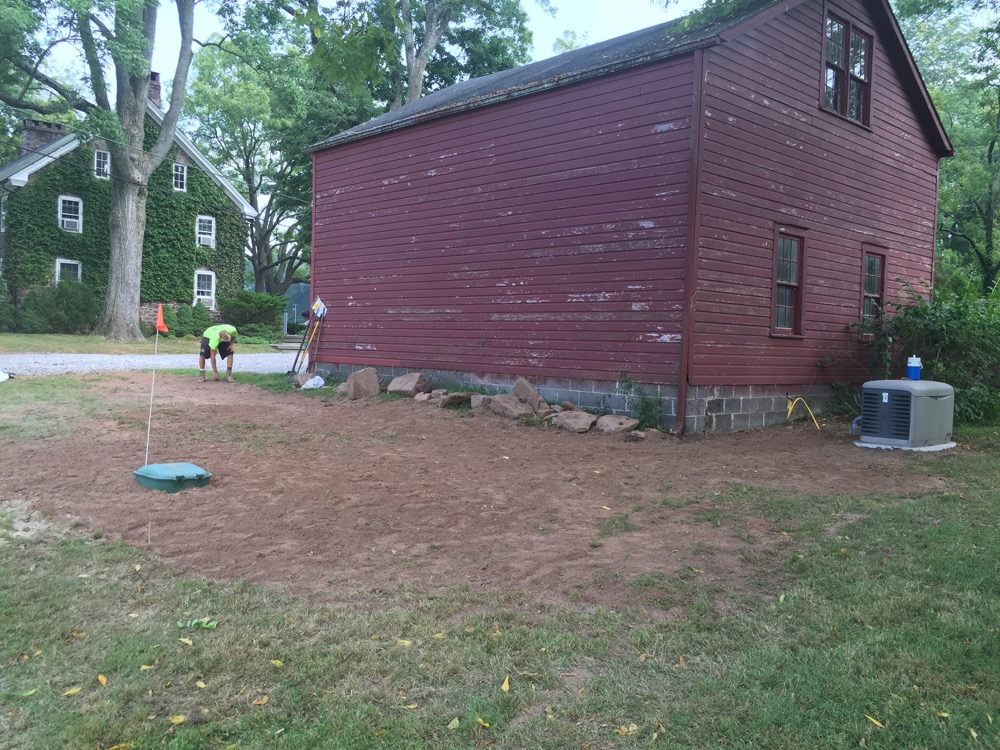

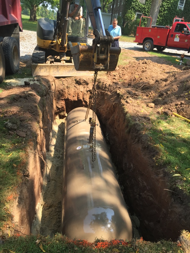

Good stuff, Doug. Just to add some figures from a recent install I GC'd for neighbor/friend...
20 RESA Kohler w/new 1000 gallon buried LP tank installed 75 feet from house. Including trenching, landscaping, transfer switch, wiring, tank (purchased) and burial and permits: $17,712.00.
It is a sweet system. Propane @ 800 gallons was $1.39/gal. Unit burns about 2.2 gph at half load.
Me? I got my 12KW Generac (gas) portable for whole house (transfer switch) and Yamaha 2400 for conservation as you noted above. I chose gasoline as it is the largest supply of fuel I have - cars, tractors, chainsaws, etc.
Knowing what I know now and based on current fuel costs, I probably would opt for one or two buried tanks of LP.
Posts: 9058
Post Options Post Options   Quote techntrek Quote  Post ReplyReply Direct Link To This Post Posted: 24 Nov 2015 at 6:05pm
Interesting. Solely due to LP cost or other reasons? Is that pic the new 20 kw installation? Wont hear that in the house, but ouch his checkbook will feel it.
Posts: 1674
Post Options Post Options   Quote fwunder Quote  Post ReplyReply Direct Link To This Post Posted: 24 Nov 2015 at 6:36pm
Yeah, pic was just before finals. Checkbook is not an issue with these folks. The request was a system that would run whole house 24/7 for three to four weeks (Sandy) and was out of sight and sound. I think we accomplished that.

Here's a good pic of us dropping tank in place.
