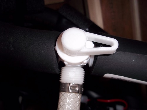

This is what the winterization valve looks like.
Direct Link To This Post Posted: 16 May 2014 at 1:22pm
I believe some pods came w/o one for a while, but newer ones got it again.  If it exists, it is just before the pump where the line coming from the fresh water tank meets the pump.
