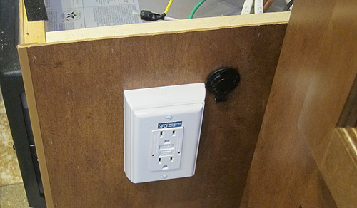

3) In locker mentioned above, removed panel covering 110 outlet. Noted wires (green+white) above entering and noticed 110 volt wire chase (channel) along outside wall.

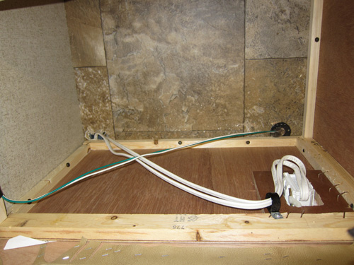

4) Removed panel below draws and noted 110 volt wire run (above) exiting. Nice easy wire run.
So, looks like one could easily tap the 12 volt bus below the pod, enter in the existing hole and run whatever along the street (port) side. Of course, it would require inline fuses for whatever you do run.

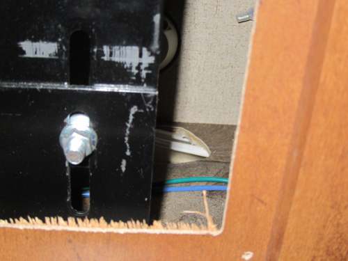

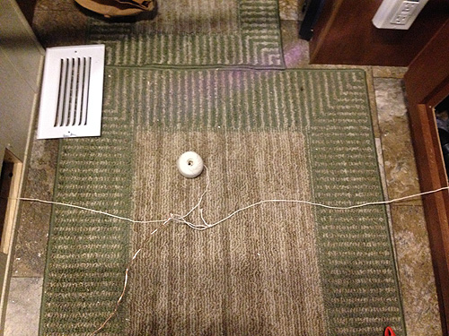

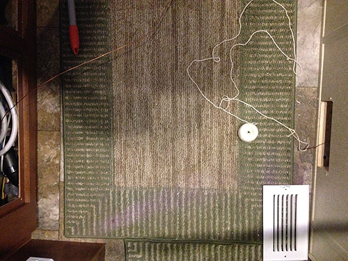

There is another chase that runs the width of the pod (178) from under the shower pan to under the slide out. It's where the shore power line runs and bathroom plumbing, etc. Short and easy access to power panel from under shower pan. It was a little trickier snaking my copper snake through it than the wall side, but not that bad. I left some strings in place in both chases for any wiring mod I might want to do. Sooo, you may not be able to run wires through the walls, but you certainly can through the floor! I use the copper ground wire from some romex scrap for my snake.

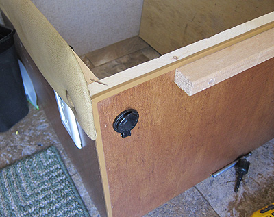

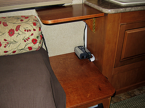

Following up on wiring options, I decided to use the slide side wire channel option to install two more 12v. outlets today using the Blue Sea Sockets recommended by others.

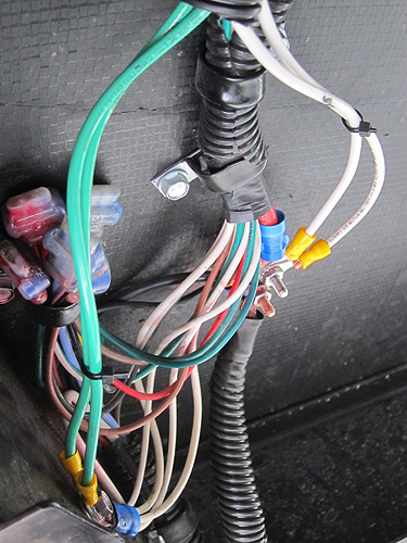

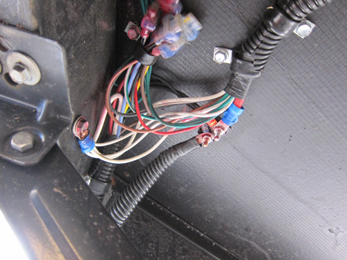

I already was using two of the three spare 12v. positions on the WFCO panel so I decided to use the main distribution post and ground under the pod. I was a little concerned about the ground connection only because of the number of connections currently being used. After removing the grounding screw and reattaching, I fell confident it's not an issue.
[edit: It's a short stop circuit breaker, not main distribution post]
Of course, I disconnected both shore power and battery power (at the batteries) before starting.

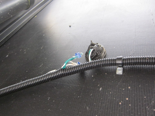

I didn't have any reservations about making a hole in the floor. Heck, I've drilled larger holes below the waterline on six-figure yachts so holes in pod floor don't worry me - as long as you make sure you don't hit anything on the way out or in! I made a large hole (1") because it was the smallest hole saw I had. I started from the inside, then made a small pilot hole all the way through and finished from below. Gave me lot's of room for wires and goop.
I used 30A inline blade fuse holders for both sockets w/15A fuses. The wiring is 10AWG thin stranded copper from Home Depot. There was enough room in the existing split wire loom to run the wires below. I added a few wire tires just for added benefit.
After double/triple checking all connections I reconnected battery and measured both sockets with voltmeter just to make sure. It's easy to get mixed up sometimes. I then filled the hole with a ton of black silicone just like FR seems to like.
I'm happy with the mod and would welcome any criticism. pics...

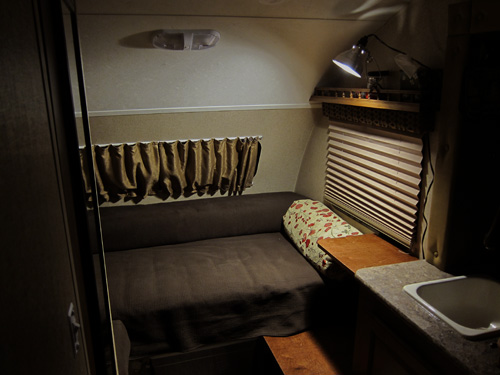

Just a couple more to add. We really wanted some good reading light in our new space aft. The overhead LED lighting is just too harsh. A little research showed that 12v. cfl's or led's in a 40w table lamp type bulb are expensive and unreliable - so I read.
We both use those little clamp on lights a lot. Me in my man cave and she in her pottery studio, soooo, I bought another one for $6.50, added a 40w "warm" LED bulb for $8.00 and plugged it into my little Cobra inverter plugged into my new 12v. outlet. I like! She likes. Nice comfortable light and @ 5w not worried about drain. Much, much nicer reading light than overheads.

Fred, The only thing that I would be concerned about is the circuit breaker that appears to be under the camper. This style of circuit breaker doesn't respond well to water intrusion. I would look into sourcing a waterproof one. I would also grease all of the connections to prevent corrosion.
Just my 2 cents worth....

Direct Link To This Post Posted: 06 May 2014 at 10:33pm
Thanks HP, but I don't see any circuit breaker or any other electronics below the pod. I'd like to know where, though.
Good idea about a light coat of grease. I didn't see any coating on the factory connections, but I'll try to find a standard.
Thanks.
Direct Link To This Post Posted: 07 May 2014 at 8:21am
Looks like he has a fuse holder on the yellow line (above), inside the pod.
Vaseline will work well to prevent corrosion and water intrusion, as long as it is protected from being washed away.
