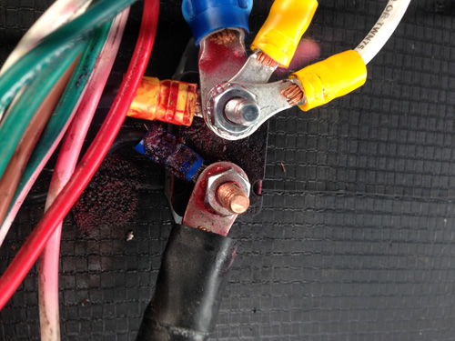

Following up on wiring options, I decided to use the slide side wire channel option to install two more 12v. outlets today using the Blue Sea Sockets recommended by others.
I already was using two of the three spare 12v. positions on the WFCO panel so I decided to use the main distribution post and ground under the pod. I was a little concerned about the ground connection only because of the number of connections currently being used. After removing the grounding screw and reattaching, I fell confident it's not an issue.
[edit: It's a short stop circuit breaker, not main distribution post]
Of course, I disconnected both shore power and battery power (at the batteries) before starting.
I didn't have any reservations about making a hole in the floor. Heck, I've drilled larger holes below the waterline on six-figure yachts so holes in pod floor don't worry me - as long as you make sure you don't hit anything on the way out or in! I made a large hole (1") because it was the smallest hole saw I had. I started from the inside, then made a small pilot hole all the way through and finished from below. Gave me lot's of room for wires and goop.
I used 30A inline blade fuse holders for both sockets w/15A fuses. The wiring is 10AWG thin stranded copper from Home Depot. There was enough room in the existing split wire loom to run the wires below. I added a few wire tires just for added benefit.
After double/triple checking all connections I reconnected battery and measured both sockets with voltmeter just to make sure. It's easy to get mixed up sometimes. I then filled the hole with a ton of black silicone just like FR seems to like.
I'm happy with the mod and would welcome any criticism. pics...

Fred, The only thing that I would be concerned about is the circuit breaker that appears to be under the camper. This style of circuit breaker doesn't respond well to water intrusion. I would look into sourcing a waterproof one. I would also grease all of the connections to prevent corrosion.
Just my 2 cents worth....
Darryl, Julie & Lindsey
2014 RP178
Posted By: fwunder
Date Posted: 06 May 2014 at 10:33pm
Thanks HP, but I don't see any circuit breaker or any other electronics below the pod. I'd like to know where, though.
Good idea about a light coat of grease. I didn't see any coating on the factory connections, but I'll try to find a standard.
Thanks.

Looks like he has a fuse holder on the yellow line (above), inside the pod.
Vaseline will work well to prevent corrosion and water intrusion, as long as it is protected from being washed away.
Posted By: fwunder
Date Posted: 07 May 2014 at 8:29am
Looks like the light pink coating FR uses on and around the 12v distribution posts is Permatex Battery Protector and sealer. This looks like a good area that should be looked at occasionally. Most Pod owners probably don't even know it's there. I stumbled across it.
[edit: It's a short stop circuit breaker, not 12v distribution posts]
No, I didn't leave any fused connections outside the pod. The blade fuse holders are from local AC Delco auto store. Radio Shack only had the mini blade fuse holders.

Fred, In in the first picture of your post dated yesterday at 5:18pm & also the first picture of them all, it appears that there is a power feed wire & a couple of other wires bolted to two studs of a circuit breaker? That is what I'm referring to.
2014 RP178
Posted By: fwunder
Date Posted: 07 May 2014 at 1:06pm
What you are looking at is a power distribution block. It's not a fuse. Hot (red) from batteries on one side and main feed to WFCO panel on the other. That's all factory installed and sprayed with Permatex Sealent - the pink stuff.
The only change I made were the two white and two green wires terminated with the yellow ring connectors - white (positive) to distribution block and green (ground) to existing ground screw on frame. Simplest, shortest run for adding circuits to street side (slide side) of pod.
Here's a closeup of the distribution block:
[edit: as noted, it is a short stop circuit breaker, not distribution block]

From the angle, it looked like a circuit breaker. I was hoping to avert any problems on your end.

Posted By: Budward
Date Posted: 07 May 2014 at 7:17pm
That is not a distribution block-  it is a circuit breaker.  On mine it is 50A.
I wouldn't have missed thatLOL
2014 179
Posted By: fwunder
Date Posted: 07 May 2014 at 7:46pm
That's interesting, Budward. When or how might that might trip and how would it be reset?
Thanks!
Posted By: fwunder
Date Posted: 07 May 2014 at 7:57pm
Ahhh, so thanks for the pointer Bud! It does, indeed appear to be a circuit breaker similar to:
http://www.amazon.com/BUSSMANN-Circuit-Breaker-CBP-50BA-CBP50BA/dp/B009K705AO - http://www.amazon.com/BUSSMANN-Circuit-Breaker-CBP-50BA-CBP50BA/dp/B009K705AO
I would guess it's an automatic reset thing.
So in my install do you think it matters was side of the breaker my power leads should be?
Good catch!
Posted By: Budward
Date Posted: 07 May 2014 at 8:00pm
They open under an overload and self reset after a short time period, if the overload is still there they open again, and so on...
There are models that have to be manually reset- but the one FR uses in this app is self resetting.   The same breakers are often used in electric brake wiring.
http://www.cooperindustries.com/content/dam/public/bussmann/Transportation/Resources/catalog_pages/BUS_Tns_12X_Shortstop_CB.pdf - http://www.cooperindustries.com/content/dam/public/bussmann/Transportation/Resources/catalog_pages/BUS_Tns_12X_Shortstop_CB.pdf

Posted By: Budward
Date Posted: 07 May 2014 at 8:04pm
Personally I would hook to the load side of the breaker.  That way your new wiring is protected too.
2014 179
