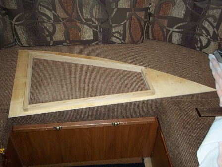

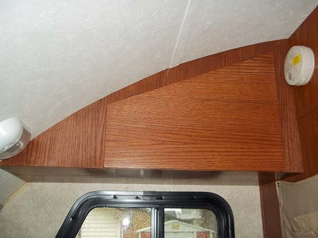

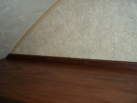

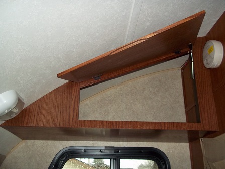

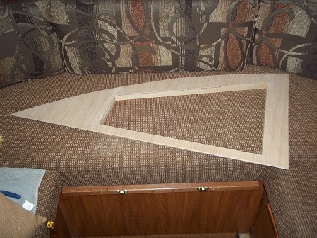

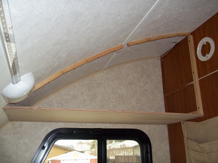

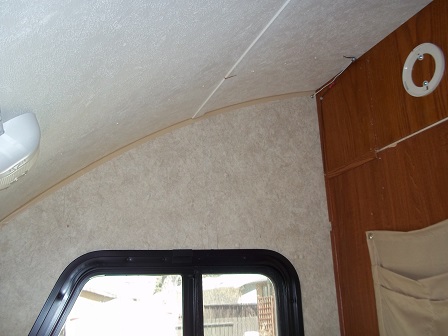

If you want more cabinet space, here is how I built our corner cabinets. Pics are worth 1000 words.
Direct Link To This Post Posted: 16 Apr 2014 at 8:26am
Just a cabinet?  That's all you did this time?
I'm kidding!  Looks good, as always.  I like how you created the support on the ceiling with multiple pieces to conform to the curve.  Not sure I would support the floor from below with a few screws.  With the dynamic loading going down the road and a full cabinet I'd put supports in from below, even though they would be visible.  Maybe if you screwed & glued on all edges that is ok.

Direct Link To This Post Posted: 16 Apr 2014 at 10:55am
Tech, the supports you are talking about are there, they are inside the cabinet. The strip on the ceiling is in two pieces with a cut almost through every 3 to 4", it is easier to keep it in line.
Just because you can't see them dos not mean there not there.

Direct Link To This Post Posted: 16 Apr 2014 at 11:50am
There is that misconception that a shelf support has to be under the shelf, not so. You can make it invisible by putting it inside the cabinet.
The supports don't have to be 2 or 3" wide, for these small cabinets 3/4" to 1" is quite sufficient.

Direct Link To This Post Posted: 16 Apr 2014 at 12:46pm
This is the second cabinet in that location, I made the first one 10" deep so I wouldn't bump my head on it, as it turned out there was a lot of room left so I made the second one 14" deep and still have room to spare.
I don't use any anchors, predrill the holes in the supports so the screws go through freely and than fasten it to the wall. I use coarse thread dry wall screws (grabbers) but be careful you don't overturn them. You be surprised how well it holds.
