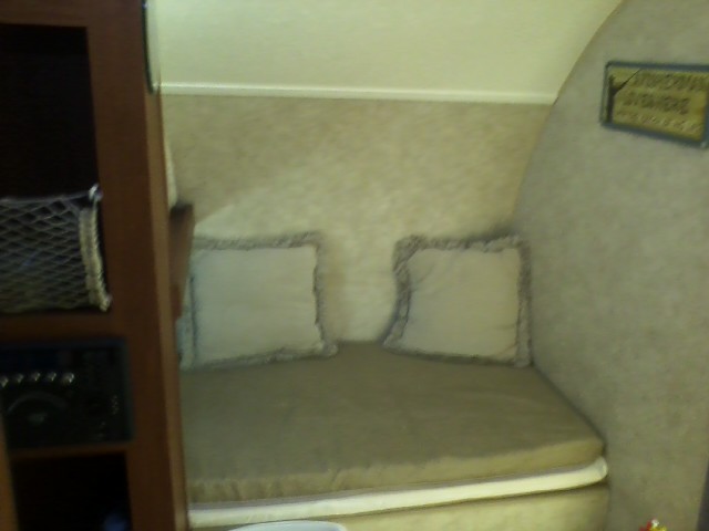

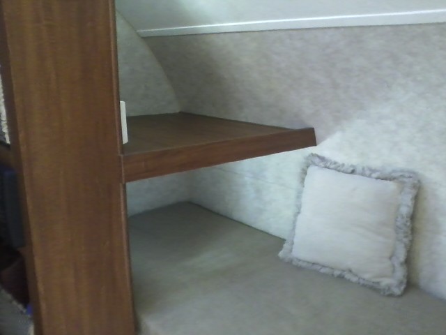

Posted: 03 Sep 2013 at 5:42pm |
Pod girl,
Sorry it took me a little while, but here is a few pictures of what I did to the top bunk......
Then I also added a 12 volt with a tv/cable plug in (that's the white box on the left) of the "use to be top bunk" which I tapped into the TV hook up / amplifier on the other side of that wall in the entertainment center. works good to set the small t.v. or DVD player on that shelf while in the bottom bunk.
Doing this Mod also allows for another place to sit.
Hope this helps in giving you some ideas!

podgirl
Joined: 26 Aug 2013
Posts: 28
Posted: 03 Sep 2013 at 6:04pm |
Wow!! It looks so much larger. Did you cover the remainder of bunk with a laminate or did you stain it? Also, did you use part of the trim for the side or add another piece? This really helps. Thanks so much for the pictures!
