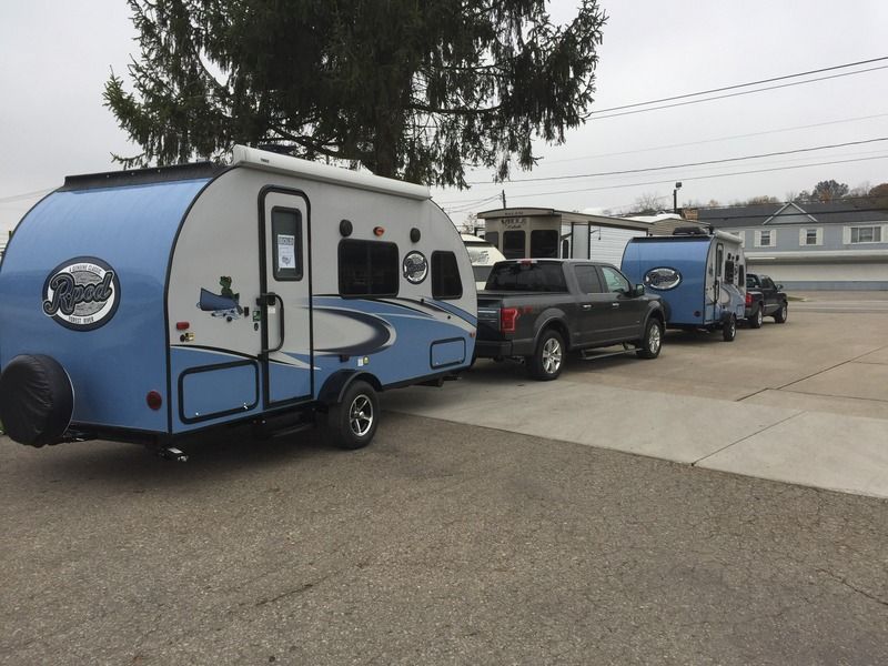

Hooked up and ready for the road...I think it was kinda funny that our pods were right next to each other when we got there. I believe there were 6 set up for delivery Friday morning....We were told they had about 28 camper deliveries this weekend Star

They look nice. I like the new spoiler. I'm not so sure about the awning since it does not look like it would keep much rain away from the door.
Here's a tip:
Take some rubber door edging and put it along the bottom of the door. A piece about 2 or 3 inches long will suffice. Use some silicone to glue it in place. Place it so that it will protect the door edge and fender if the door is opened too wide. It looks like there is still no stop to prevent the door from hitting the fender. This will address that so the fender does not get scratched up by the metal door edge.
