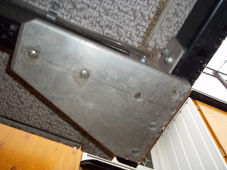

I put on skid plates almost 3 years ago, haven't scraped bottom since.
I used 1/2" aluminum.
