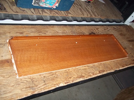

The stain is my own concoction. It depends on what kind of wood you use because every wood has it's own color.
This is the shelf from the cabinet I took out, as you can see the shelf has a support on the back and on the right side, those have to be glued to the shelf to become one, then you put the strip on the right side and on the ceiling. When you glue the front into place the whole thing becomes one. It's not going anywhere, my cabinets have bin in our trailer for 3 years and nothing has moved.
The front is 1/4" oak plywood with a frame around the door on the inside opening to stiffen it up. Most of the material for my cabinets is 1/4" plywood.

I did see the supports above, I was only questioning if they were supporting the shelf via a few screws, or screws + glue.  Only screws and I'd worry about failure in a camper.

No glue, just a few drywall screws into the wall
Direct Link To This Post Posted: 16 Apr 2014 at 9:17pm
I'm talking about the interface between the support and the cabinet floor, where vertical forces will pull on the screws as the pod bounces.
