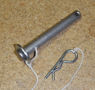

We have a steep incline driveway.  Replaced the bolts on the rear scissor jacks and replaced with clevis pins.  Now we can remove the rear jacks when coming or going without incident.  May also come in handy when boondocking on rough roads.

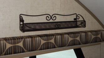

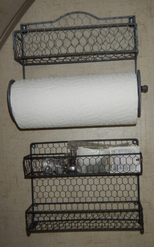

Added wooden rack and metal shelf on passenger side kitchen.  Wooden rack from Target and metal shelf from Amazon.  Read lots about attaching things to walls.  Didn’t want to do velcro or command strips. Understand concerns with screws, but wanted these mounted more permanently.  Used some ¾ inch coarse machine screws.  Drilled pilot holes and then hand screwed.  Careful not to over tighten.  Then used caulk squeeze in each hole and re-screwed.  They are sturdy and well anchored to the wall.  Won’t load up with heavy items when traveling.  Will be great at camp to free up counter space and be organized.
Added metal paper towel holder with shelf and small metal spice rack on driver side kitchen.  Both purchased on Amazon.  Same installation as above.

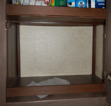

Added additional shelf in upper pantry and stained and installed some wood barriers to keep items in pantry from pushing open door or falling out.

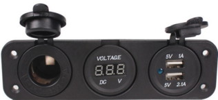

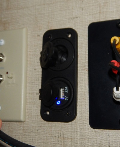

Installed three USB/Cig Sockets for 12v charging and electronic use.
  • By the kitchen plug driver’s side,

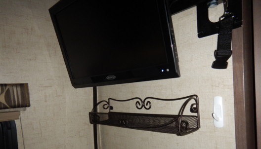

  • By the TV/stereo (pictured)
  • Down by the bed plug.
Will change out one of the cig sockets for a voltmeter.  Also bought some rocker switches to kill power to the blue LED on the USB if it proves to be a battery drain next season.
 Put the same metal shelves over valences over bed windows and under TV.

  • Purchased a tilt mount on amazon and installed on the tv arm for vertical tilting.  Greatly improves the tv viewing while in bed and at dinette.  Had to do a little metal bending to make it fit.  StephenH, still working with a local fabricator on that total tilt that was posted earlier this summer.

Had to order the clevis pins from amazon.  As you know our hardware opportunities are limited here in the WRV.  3-inch long by 3/8 diameter.  The original bolt is metric and the 3/8's is the slightly smaller SAE equivalent.  You can find at Home Depot.
