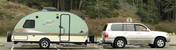

Love the mods! Miss the WRV!  I like that you posted some pics with the cover on.  I think we have the same one but did yours go on VERY tight at first?  I posted on another thread but here's the pic of us trying to put it on tonight...
