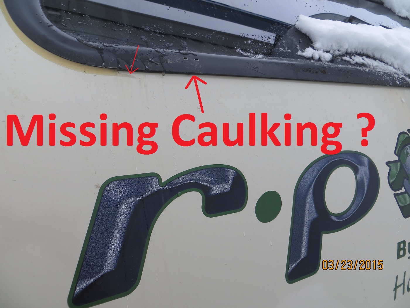

Just notice that the caulking n the rear window does not go all the way around. Someone with a 179: please help me confirm if the caulking should be all around the window ? The bottom portion of mine does not have any caulking or sealant.

Welcome, my side windows have a gasket no caulk, the rear window has a gasket caulking on top and half way down the sides.

My rear window on our 179 looks just like that and I haven't had any problems.  I think its designed like that for drainage.

Same here, looks the same.

it is supposed to be like that.

The guy that bought my 171 kept insisting that I had worked on (or had someone work on) my back window.  It came like you describe.  This was after the early problems with leaking rear windows so I hope he believed me when I told him that was how the factory did it after that problem with earlier models.

We don't own a 179.. but our rear window is the same.. hasn't been a problem yet..

Thanks to everyone for the reply. I feel much better now. it looks to me like, someone forgot to finish their job.

My 171 has a gasket and caulk around the entire rear window.  But, the window itself has a weep hole to let any accumulated water out.

looked at mine yesterday; only has caulk on top and only about a third of the way down the sides; no issues.  hogone
