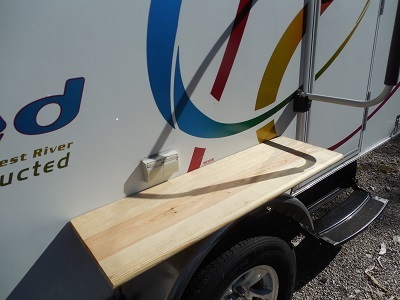

Due to the Pods lack of storage and shelf space I make a inexpensive fender shelf from a $9.95 prefinished stair tread, a couple of eye hooks and bungee cards. I used 1x1 strips to center the fender and applied self adhesive foam strips to keep it from sliding. works pretty good.

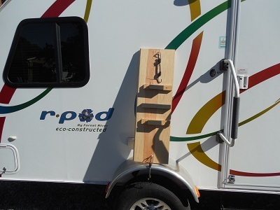

here is a picture of the bottom with the foam applied to keep it from sliding and marking the fender. (I had to double post is as I don't know how to add multiple pictures, heck I am lucky I can resize to get to post in the first place)

I came up with this as Donna does not like the smell of coffee, so I put my fresh ground beans in my little maker and the electric plug is just beside the shelf. it works great, weighs less than 4lbs. If you get lucky and catch some fish I will transfer the shelf to the hook up side and Donna won't come out when I am fileting fish and holler, ohh yuck. easy clean up and put away till the next time.

techntrek, I used the resize website and I always have trouble selecting what will fit in the pod site. I will try to repost larger pictures any suggestions ? I use the resize images on line. the shelf works well, is quite sturdy, you can use it on either side. with the one by one wood pieces I leveled the shelf and then slid the one bys up on each side of the fender, marked them and screwed them in from the bottom. I used one inch square foam with an adhesive backing on the bottom of the one bys and one in the center of the shelf, this keeps the shelf from sliding on the fender. the bungees keep it quite stable.
