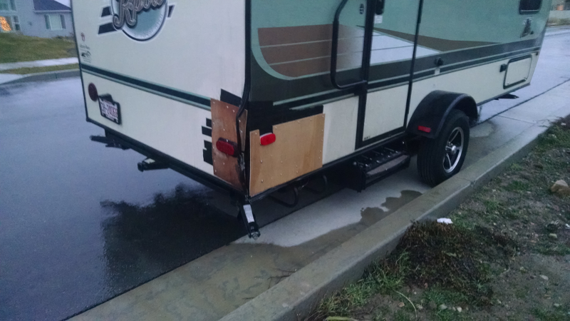

I did some more patching today. I think I have it close being able to make the trip back to NC. I want to address the front corner which was not as severely damaged, but is nonetheless damaged enough that I don't want to tow it home until I get at least some Gorilla tape over the cracked places. I need to wait for it to be dry again so that the tape will stick.
The repairs so far are with 1/4" lauan p[lywood treated with three coats of polyurethane sealer on both sides.  These are over the top of the Gorilla tape I applied earlier. I got two side-marker lights at Camping World. I used the amber lens from the one to replace the missing one. I had to replace the red marker light fixture as it was broken along with the taillight.  We are blessed that the frame was not affected, so we will be able to get it home and then see about proper repairs.
