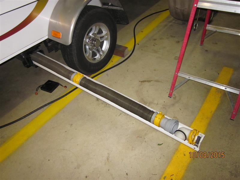

Here is what i come up with, at least for now. 5 inch pvc post cover with caps. I sealed the far end and will have a gasket on the end I open. the ends that are on my hose are 4 1/2 in and would not fit in the r pod holder.this makes it  so I can put the 90 and the pipe size adapter  in there to
