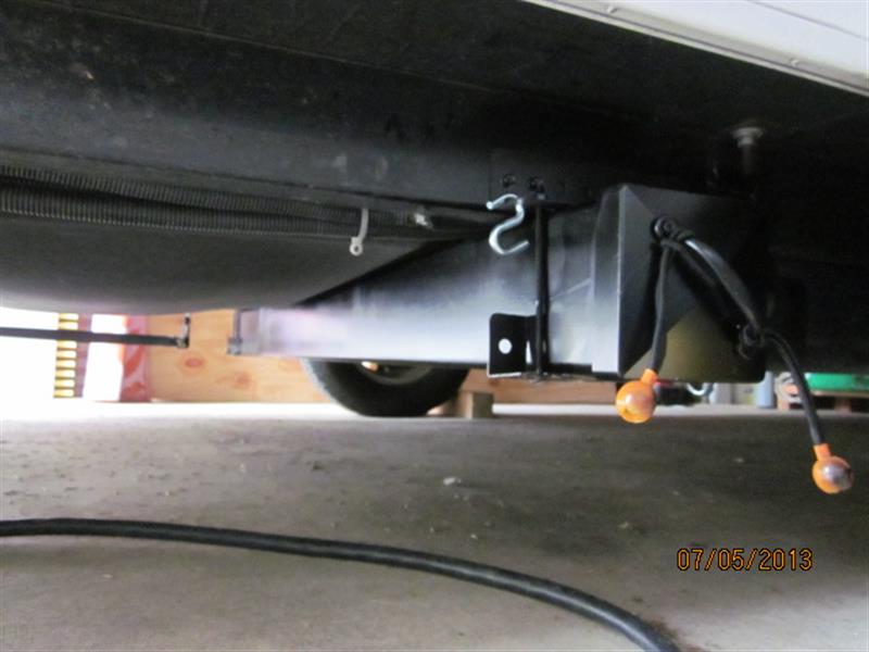

I took the short sewer hose tube off soon after getting my pod 4 years ago.  Without the risers anything that was below the frame was a problem (I got a fold-up jack and took the original jack off, too).  Plus it wasn't long enough to hold anything.  Since then I've used a large plastic tool box to hold the sewer hose and accessories.  Not ideal since it was hard to get the hose in there and the box had to ride inside the pod.
With a big trip coming up I had to finally get this annoyance off of my checklist.  I ordered a 60" sewer tube from DWI, which is long enough to fit between the frame rails near the 171's sewer outlet.  I like the ends of the tube better than the old tube, both ends have a little knob and a door which swings open where the original screws open and closed which wasn't always easy.  This new one holds everything including the threaded adapter so I'm happy.  And no more tool box...   http://www.dwincorp.com/products/82/SUPER-TUBE - http://www.dwincorp.com/products/82/SUPER-TUBE

On the sewer tube... you said it mounts between the frame rails. Does that mean it screws to the floor? Or did you screw it to the rails with self tapping sheet metal screws?
I want one... 1
When are you coming to New Orleans?
Posted By: techntrek
Date Posted: 11 Jun 2013 at 10:16pm
I taped the tube in place, then marked the mounting holes, removed the tube and drilled the frame.  Then used self-taping screws.
We'll be in NO somewhere around July 10th-13th.  I don't have a copy of our schedule on this computer so I'll have to verify that later.

I'm going to do this but I have questions too. The Sanitube web site says that the R-Pod requires the 25.5 in tube but you went with the 60" tube. Because? I'm also going to move from the stock "slinky" to the RhinoFLEX sewer kit. I can't find info anywhere as to the stored length of the Rhino. Is that going to cause me to go with the longer tube? Thanks for your posts and all this help.

The 60 inch Sanitube contains the 15 foot RhinoFlex AND all the accessory fittings including the elbow. It even accept a clear 45 degree elbow, buts that's getting tight. The stock 60 inch tube can be mounted using #14 sheet metal screws, but positioning takes some care. A custom 61 or 62 inch tube would be easier, but you have to make it VERY clear to the manufacturer you don't want the standard tube. Returning a tube is a real pain. The old tube can be used for other accessories or things. I'm going to use it to carry a shorter hose for use with a "blue tank" when needed.

Don't remember exactly, but that sounds about right. The tube itself is fairly cheap, but shipping drives the cost way up. Most, if not all, of the extra $35 is for shipping. I thought that's crazy but I checked with UPS/FEDX and that's what it costs. The extra length tube is almost no extra cost, but shipping the extra length is $$$. They just cut the tube a bit longer and glue the end assemblies on.
Carefully measure the center-to-center distance between the frame rails. I measure close to 62". This will put the mounting holes in the centers of the rails. AND! Be sure to make it very clear on your order that you want 62" center-to-center mounting holes. I called the factory: they said no problem, same price. I wrote it on the email order too and referenced the guy by name. Guess what I got: 60". It works but it's harder and shipping the 60" tube back is a pain.

Please verify your measurements before you order. I measured my 2013 RP-172. I expect they're the same as yours but it's worth a check. Center-to-center of the rectangular frame channels. The channels are nominally 2" so you'll have about +/- an inch to play with.

Neither, I had to scrounge the screws from my large "coffee can" collection.  No instructions, but none needed.  Just position the mounting holes where you want them, mark, and drill the holes in the frame.  Yes, my hose has the multi-threaded adapter which fits most campground sewer connections, the 90 degree elbow which fits into the mult-threaded adapter, and the standard camper connection.  I was worried the adapter wouldn't fit inside but it does.

25.5 inch is the length where the stock tube is mounted under the battery box.  60 inches is the length between the frame rails on the body of the pod.  My hose is way too long to fit in the stock tube but there is room to spare in the new tube.

I believe my rails center-to-center were closer to 61 inches.

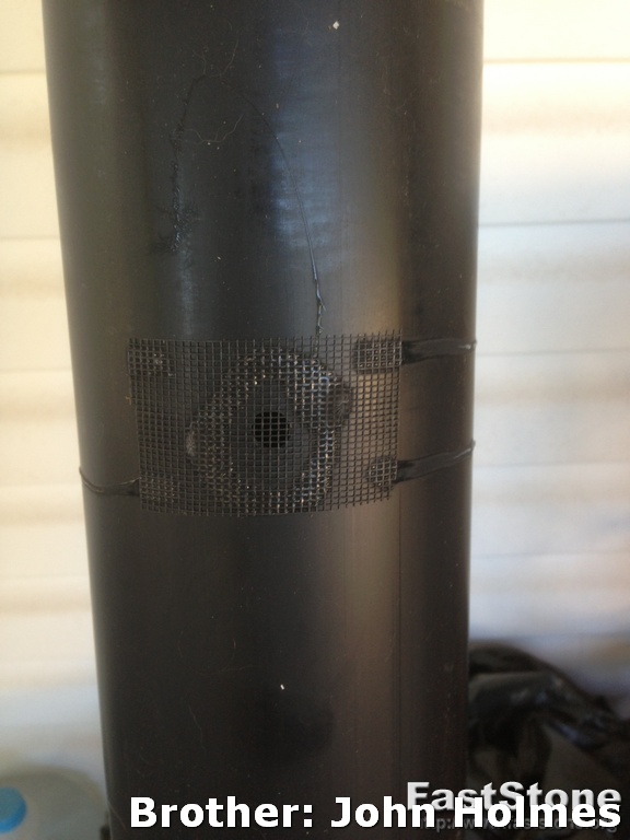

Good idea!  So, I got one!  I added 4 drain holes and covered them with some plastic bug screen to keep the wasps out.  I used good old super glue to attach the screen.

Posted By: TerryM
Date Posted: 20 Jun 2013 at 11:19am
I haven't mounted mine yet.  My Pod is out in the sun and it has been, and will be, in the mid to upper 90's.  I'll have to go see where it will best fit though.

Terry - nice mod of a mod!  I considered drilling several small holes, something too small for bees, but decided that any liquid would seep out on turns through the side doors.  They are fairly tight but not watertight.  If I find otherwise I can always drill later.
