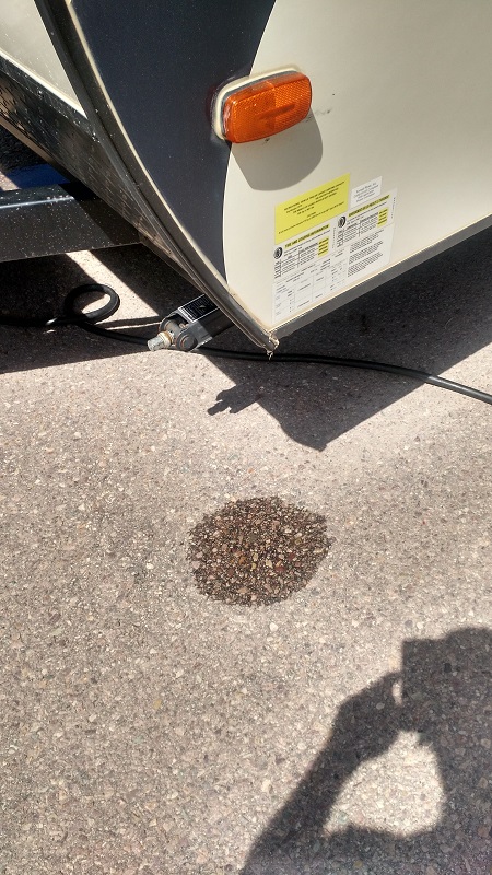

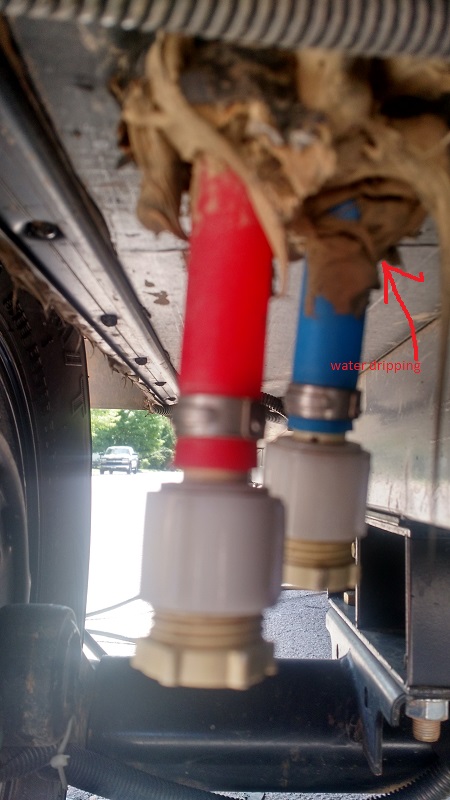

Hi all, I am following the de-winterization guide.  I filled my fresh water tank, and I have a very small drip coming from the caulk around the cold water blue line coming out of the RPOD, and a very small drip coming out of the front corner on the same side.  I do not see any signs of water running anywhere in or out of the RPOD elsewhere, so I'm not sure where it's coming from, but it is concerning? Any ideas?!
Direct Link To This Post Posted: 05 Jun 2016 at 7:00pm
I assume you pressurized your lines?  It wouldn't be coming from the fresh water tank itself, that appears to be running around on the floor, coming out a the corner and where the low point drains are.  So start tracing the water lines inside looking for the leak.

Direct Link To This Post Posted: 07 Jun 2016 at 11:16pm
Think I might have figured it out. Th caulk on top of the satellite connection is completely separated. This is under the freshwater fill port so I'm sure water spillage was getting in there. I'll have to re caulk. I'll have to search for the recommended caulk also
