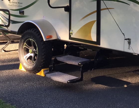

1. Change entrance step to 2-steps.

Do you recall where you got the two steps?

I called my dealer, where I purchased the R-Pod. He sold it to me at cost, $86.00
The spets were 1/2 narrower the the original. Nothing a couple washers could not make up for.

As for steps, I installed these from eTrailer. I just had to enlarge the back screw holes a bit. Otherwise a perfect fit.
https://www.etrailer.com/RV-Stairs-and-Steps/Stromberg-Carlson/SMFP-2100.html
