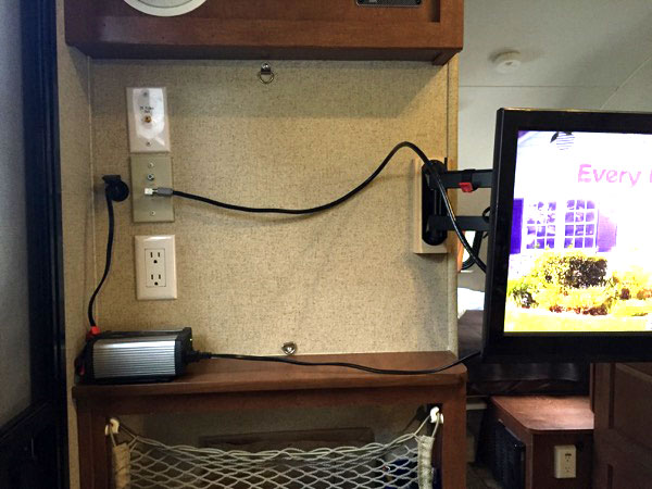

Last one, I promise! Tongue I just figure outlets should be convenient.
This is my fourth Blue Sea Systems adapter install and I think it's really the best place for one. It's an easy drop (I use a pyramid sinker tied to a string) to the panel. I use 14 gauge for the two adapters close to the panel w/15 amp fuse. The adapters on the other side of the pod are wired with 10 gauge and run to short stop circuit breaker under pod.

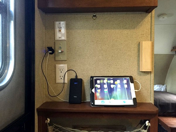

This location is convenient for small inverter for TV or charging station for USB stuff when TV is not docked.
BTW, I measured the TV with Kill-A-Watt while hooked to inverter. Draw was 15 watts.
Fun!!

I noticed you used 90deg elbow on the coax, to keep the profile lower. I like that idea. I have to go scavenge through my home theater stuff, I think I have one somewhere...
Direct Link To This Post Posted: 23 Apr 2016 at 12:13pm
Yeah, Retro. I used a 90 on both TV and wall. I use a stubby HDMI cable on back of TV too.

I'm curious about your inverter...  I'm looking at a pure sine inverter but not sure if I really need to.  Do you have a pure sine or modified sine inverter?
The pure sine inverters cost 2 to 3 times more and  I don't want to spend the extra money if I don't need to.  All I would use it for is the television.

The inverter I'm using is just a little Cobra CPI 480. I use it for the TV, power a small lamp occasionally or to charge up laptops. It's really never given us any problems and it's cheap.
Awesome....  Thank you that will save me about a hundred bucks or so!!  Thank you so much!
