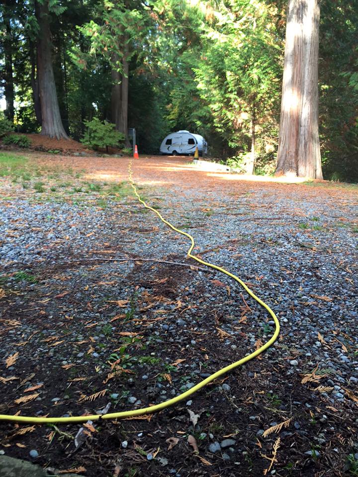

thank you all again for your responses. I am most likely going to just detach the negative from the battery over the winter. I did that this past week and it conserved the battery level fine. I am testing out the charging now and it seems to be working great from the distance with the extension cords so I'm going to return the trickle charger to Amazon. I can rebuy it later if need be. I live in the Seattle metro area-- and even though we usually get a few cold spells each winter, most of the time the temps are above freezing. I live in a very safe area and my Pod isn't viewable from the street. A lot of my neighbors have RVs and trailers too. I have a lock on the hitch and I can try to lock the battery up, but it's not a big concern.
