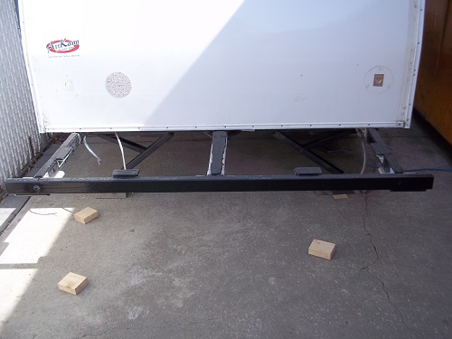

There are many things you can do without welding, no welding on my backend of the pod.
