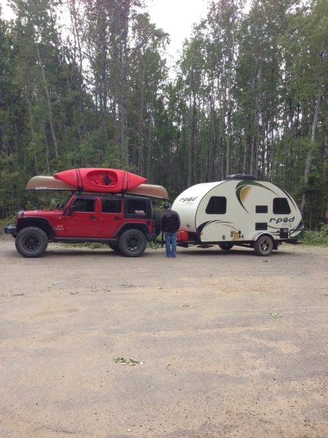

Direct Link To This Post Posted: 20 Sep 2014 at 10:32am
The Wrangler is rated for 3500lbs and has a tough go.
I'm sure a WDH and overloads would help, but the minivan motor just doesn't have the oomph. My get-up-and-go has got-up-and-went.
-I should really have that on a bumper sticker-
That's the power button..press it.
Turn it all off.
Go outside!
'14 RPod 171
'09 Jeep Wrangler JK (mine)
'14 Dodge Ram 1500 4x4 (hers)
