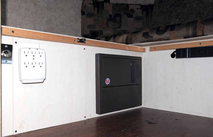

I added a 750 watt inverter(red box) and attached a black outlet strip for use when boondocking.  I also added an additional 12 volt outlet and a 110 multi-outlet .  All of the water pipes have been wrapped in foam to suppress noise.  I also mounted the water pump on a 1” foam base for noise suppression.  I also relocated the table locator pin to the opposite side to avoid any more shin cuts and bruises.

Install surge protected outlet strip –connected to inverter
