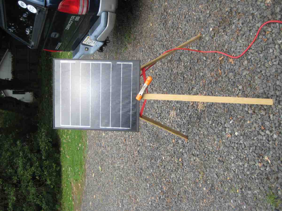

That's an awesome chart, thanks for the link. I looked into the source of the data and it's assuming a fixed panel averaged throughout the year. Luckily they have a handy calculator on their website: I put in Average July with a two-axis plate (since I rotate and tilt my panel during the day), and it came up with this: In my region that's 8-10 "sun hours" per day, even more than I thought. June and August were about the same: 7-8. Since we only camp May-September it works out well for us. As for the line-losses, check out this calculator: My configuration shows 0.45% loss, so pretty insignificant (0.1Ah less).
