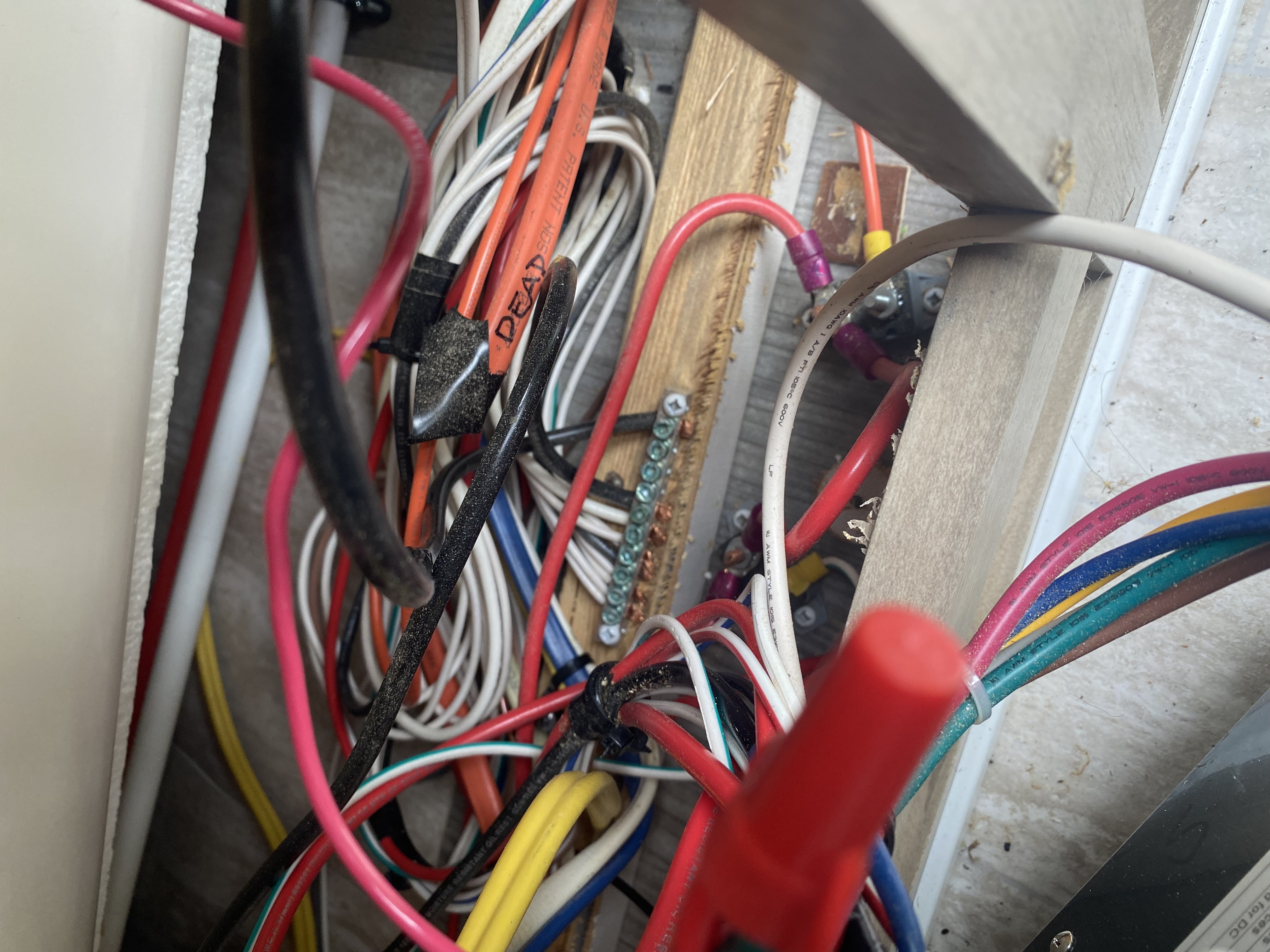

I found a YouTube video that explains the converter wiring, both 120 AC and 12 VDC. I pulled the converter from the wall and there is a buss bar for all the DC grounds, behind the converter, mounted to the floor!?  The AC neutral and ground buss are accessible with just taking the cover off the converter. The hardest part was pulling the wire, up through the wall, from the converter at floor level, to the radio panel close to the ceiling

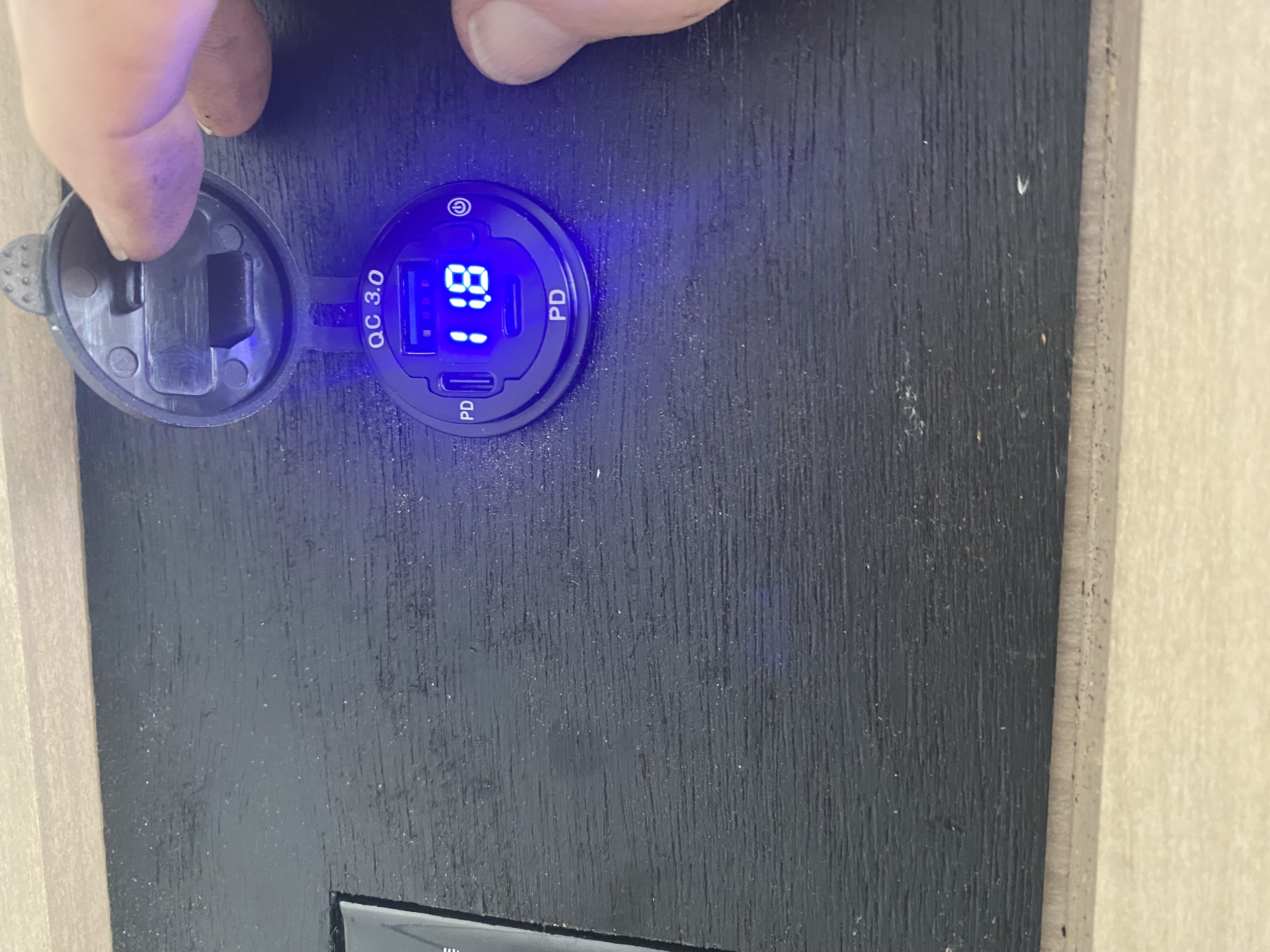

Update with pictures.
The voltmeter/charger is installed. First thing I noticed is that I need a new battery!
RPod 189, installed in upper panel, next to the radio.  Also the same area as all other switches, including slide, awning, and lights.
Here’s the installed picture, along with a look behind the converter.  You can see the row of white ground wires attached to the buss bar.
