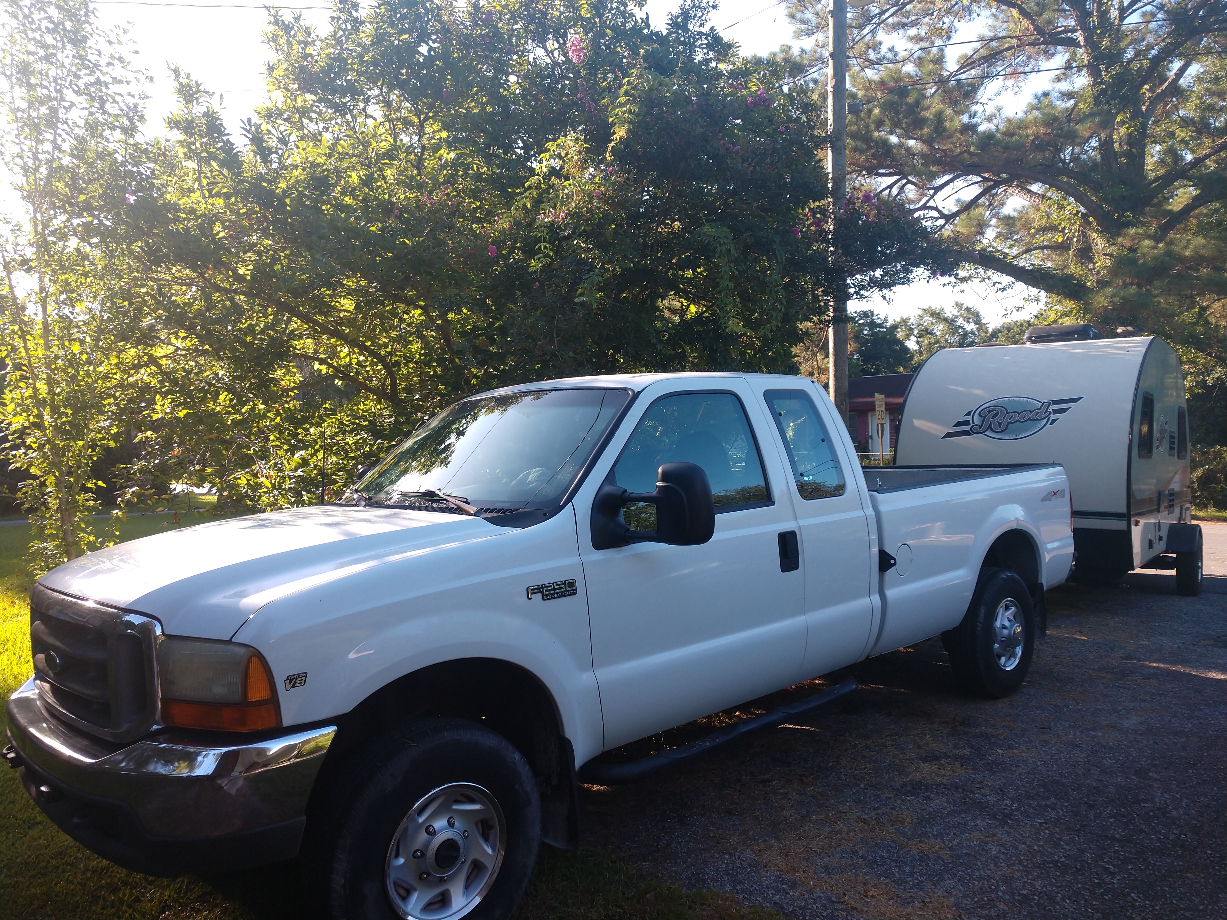

I have a 2017 171.
Does it have backup lights?
Also, my running lights cut on with the headlights but, stay on when I cut off the headlights. I have to unplug the camper from my truck to get the lights off. They reset to off until I cut the truck headlights on again then they stay on.
Any ideas?
