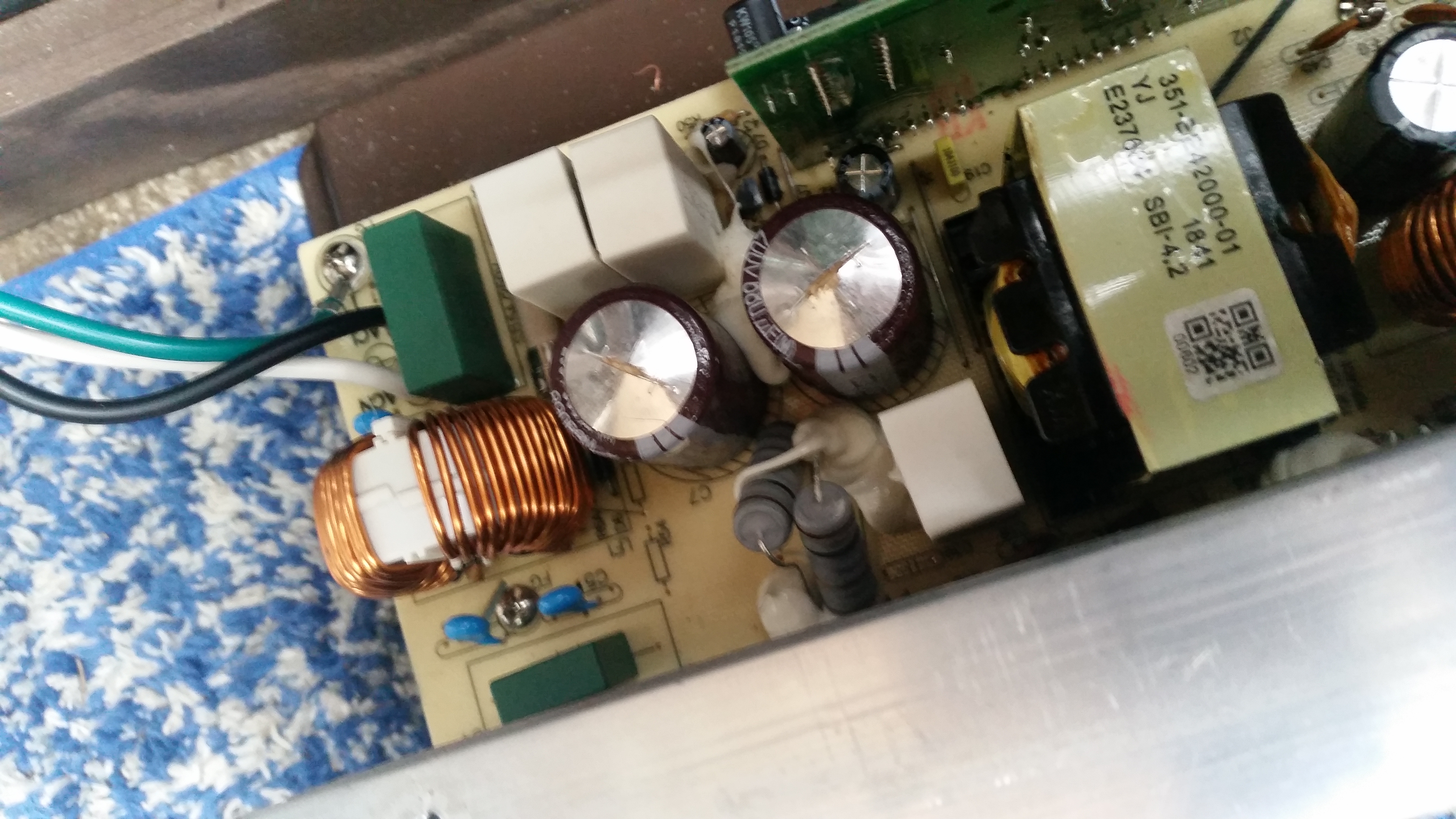

First time connecting to 30 amp power, I heard a pop and smoke was coming from the power inverter
For the last month I have been testing the camper with 15 amps and no problems. I take out the power converter and notice two capacitors are bulging on top and there is a oily fluid all over the board probably capacitor fluid. So I either replace the capacitors with the same rating or find a new 30 AMP WFCO converter. Has anyone had this issue. I had a feeling something was going with the electrical because the battery lost charger after a week of being off ( not connected to power) |

I have the 2017 R-pod 179 The model number is WF-8955PEC, but I thought since the camper is rated for 30 amps I would need a 30 amp converter. Thanks for that explanation. I did wire the outlet myself, I took power from a old water heater connection ( pretty sure its 120v because it's a single breaker) Say I did wire it incorrectly 240 instead of 120v, would this be a similar outcome? Odd thing is that I tested it on 15 amp immediately after the incident happen and everything seems to be working, then retested the 30 amp, and no pop but with the control module out you can see smoke rising from the swollen capacitors. What would you want for the inverter? Located in Gainesville, Florida Was planning on moving in this weekend as I finish fixing up my mobile home.

So that is my problem. I gave it 240 amps instead of 120. Hope I didn't destroy anything else.

If you somehow got 240Vac across those caps they would almost certainly cook off on you. Can you be a little more specific about what and how you wired things up? Do you have a voltmeter you could use to check what you are supplying to the trailer? It needs to just be straight 2 wire (line and neutral) plus ground 120Vac.
Posted: 03 Jun 2020 at 5:24pm |
Likely, you did smoke the converter with 240V. The 30A outlet must be 110V. Don't bet on the water heater connection being 120V unless you actually took a meter and checked. If so, it was a wonder that you did not cause more damage to the RPod. I installed one myself for our RPod. Since I was starting from scratch, I did not have the issue of wrong wiring. Here is something I looked up about water heater wiring: https://www.thespruce.com/safely-replace-electric-water-heaters-1152637 "Electric water heaters require a 240-volt dedicated circuit, which

Yes I did. Good lesson to test with a voltmeter whenever making new connections. I am good with electronics, but I make stupid mistakes sometimes. I removed the neutral leg from the 240 30 amp breaker and attached it to the panel neutral as a 120 would be. Tested with a volt meter, no issues with camper so far.

![]() Picture for reference.
