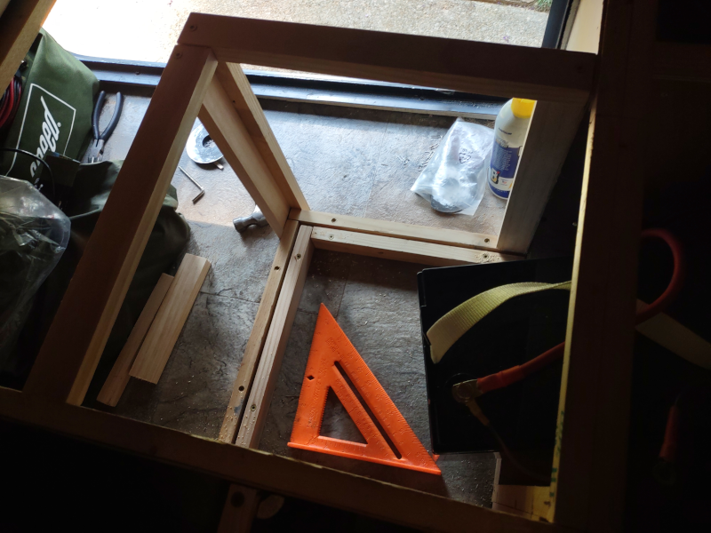

I used the foam tray that was padding the battery in the shipping box to get the basic size. I felt it would be good to use it with the battery also to cushion the battery from road bumps. I figured out the size and cut the paneling between the existing compartment and the basement outside accessible storage after moving stowed items out of the way. I built a framework and support for an additional raised floor section to match the floor I had put in the prior battery compartment to cover the wires and plumbing. This picture shows the completed framework.
The double cleats at the bottom are to both hold the new panels and to hold the floor. This will be evident in the next picture.

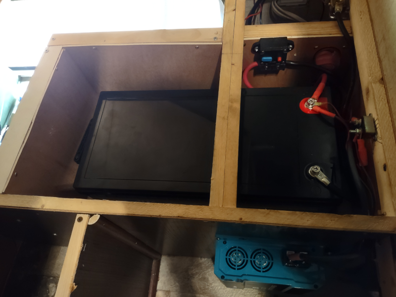

After assembling it, I ended up having to take off the end panel because the battery would not clear the cleats that were part of the original compartment. I did not want to remove them because they do help support the bed platform.
Now for the final picture. This shows the battery installed and connected. I did have to switch out negative battery cables because the one that I used with the 100A battery was a little too short to reach. I did not route it through the hole I previously cut for the old cable because the one I used was not that much longer. I reset the battery meter for the larger capacity and the converter charged it. It is now running the refrigerator. The seller said, "When using for the first time, please complete a cycle of deep discharge and full charge so that the battery capacity will be automatically corrected." This is what I am doing now. Plus, this will give me a good idea of how long I can run the refrigerator on battery. I'll add information about that after I get this initial setting done.
One thing that surprised me about this battery is that the manual states that it has a "Low temperature heating function."  There is an internal heating plate that will warm the battery so that it can be charged in temperatures as low as -31F (-35C) and high as 122F (50C). Discharge temperatures are -4F (-20C) to 140F (60C). This will really be helpful if we need to camp in freezing temperatures again.

Great write up and great job as usual. That is a pretty big battery. Hope you have enough storage space left to be useful What does it weigh?
I guess the other place to put it if someone wanted to retain the outside storage in the 179 would be to build a box in the under the bed storage area, perhaps also use that structure to create a better duct system for the furnace.
I assume the self heating is done internally using a 12v resistance heater run from the charger? Do the specs provide a current demand for that? Using it might require a charger upgrade.
