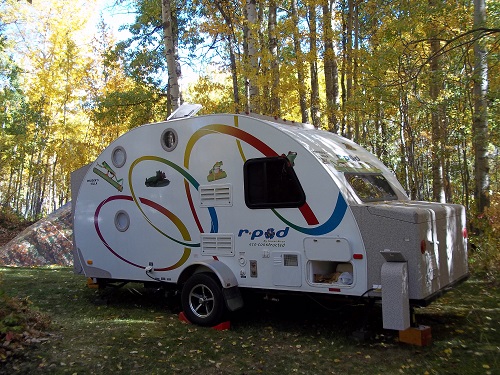

Here is my setup from generator to pod, you can see where both ends are plugged in.
