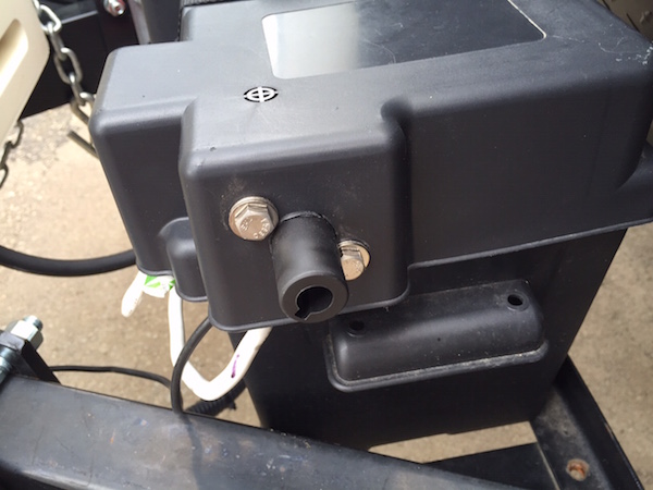

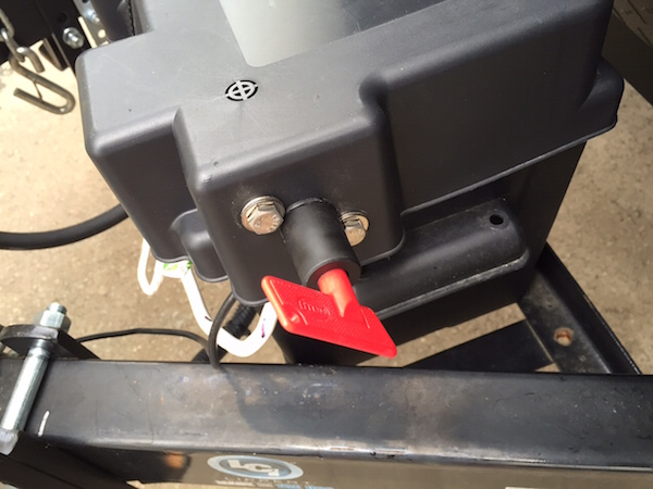

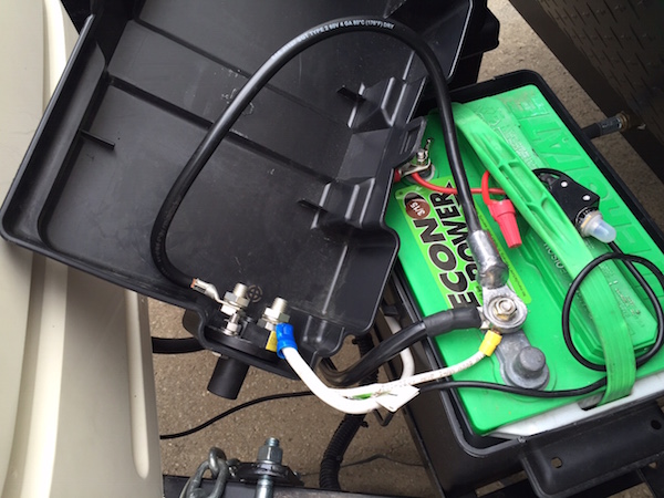

Not to be a contrarian, but I just installed a cutoff switch on my 178 dual bank and all my research recommends using the negative side for safety issues. See Youtube video below:
