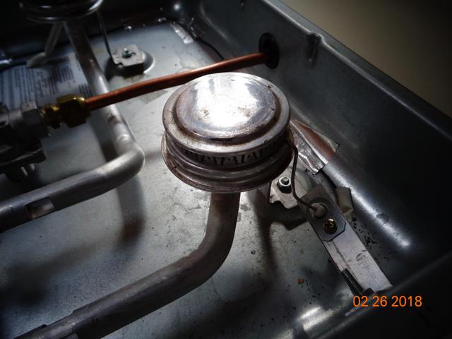

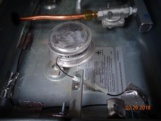

In a sense, it is self-grounding. The current goes to one igniter and jumps to the burner. Then  the current goes through the stove's body to the other burner and jumps to the other igniter. Then it travels along the wiring back to the piezoelectric's second contact. The battery operated module I put in works similarly. Only on that one, I had to use a short jumper wire between the second set of contacts.
