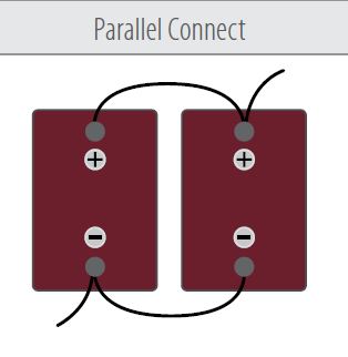

Ditto above comments from Techntrek. You will get more out of your two 12V batteries by connecting them in parallel and a whole lot less fuss. Connect them like this:
Note that the trailer leads are connected to opposite batteries. The positive of one and the negative of the other. This distributes the load and charge evenly which is important for maximum battery life. |

Thank you all for clarifying this. Will go this route and try it and see how much more I can extend my dry camping time. All I need to get are a couple of heavy cables to go from + to + and - to -.
Joined: 29 Nov 2015 Location: Wake Forest, NC Online Status: Offline Posts: 6463 |
Posted: 02 Mar 2016 at 11:32pm |
You should be able to find suitable cables at any auto parts store. They are not very expensive. The diagram CharlieM provided is a good reference to use when you do get ready to hook them up.
