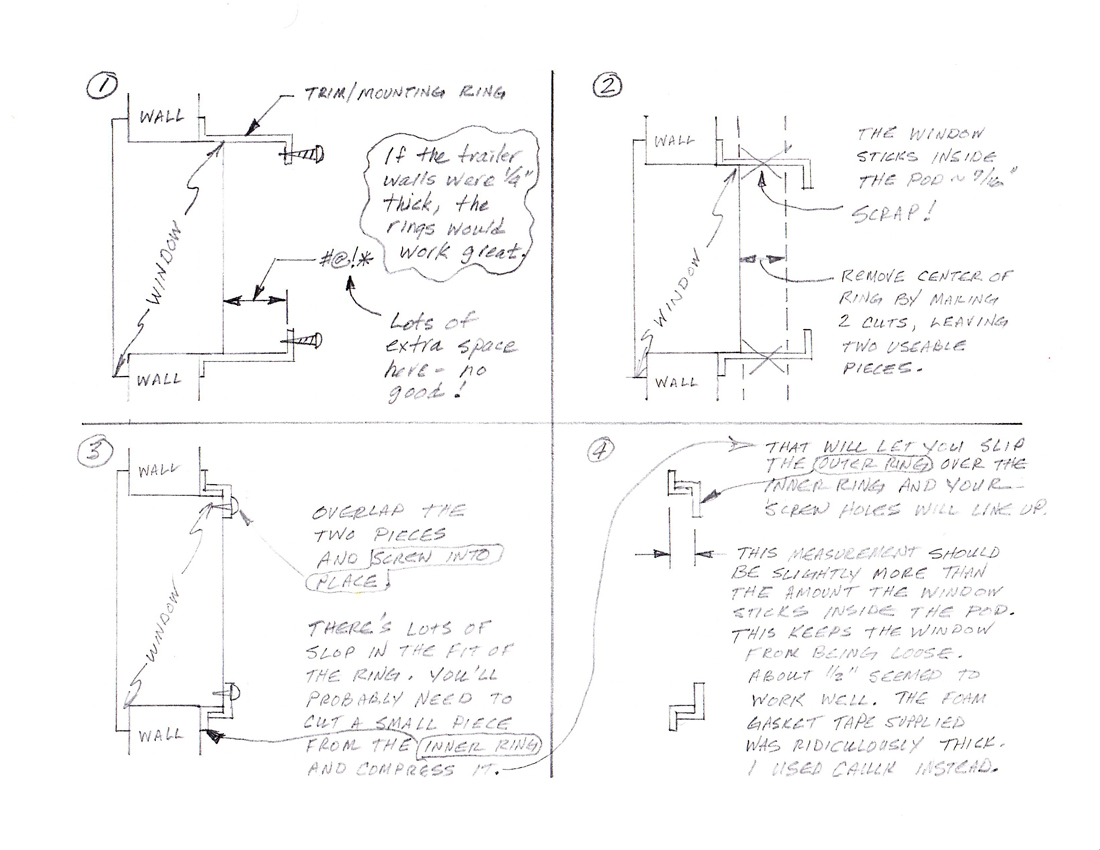

Second, the trim/mounting rings that come with the windows absolutely will not work with the pod, no matter which way you turn them or how much you cuss. These windows are a bit thicker than the Scamp and rpod walls, so the mounting/trim rings work differently than the rest of the windows in the pod. I had a hunch this might be the case, so before I ordered, I lined up a source to make me whatever I might need for trim/mounting rings. Once I got these windows, figured out what I needed, and made a really really nice professional sketch, my source backed out. Crap. This forced me to modify the rings that came with the windows. This involved a hand grinder, jigsaw with metal blades, file, some blood and some cussing. If you are really interested, PM me and I'll give you all the gory details of what was involved.
