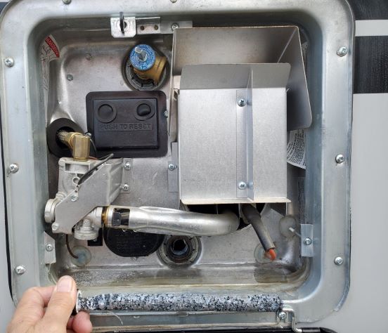

I purchased a suburban anarod and received from Amazon a PN 233514. I’m not sure they sent me the correct one. Will this one work?
Thanks
Mark

I pull the anode rod every fall to drain the hot water tank when I winterize the Pod's plumbing. I have noticed that the anode usually has some magnesium loss where the magnesium touches the rod 'bolt head'. I believe that the acidity of the water that is in your tank makes a big difference in rod loss. Last year I found much more rod loss than this year...camped in different parts of the US.
I usually replace the rod before all of the magnesium is gone. Years ago I left a rod in and the end of the rod broke off in the tank because the central wire was the only thing holding the remaining magnesium to the bolt head and the wire broke.
