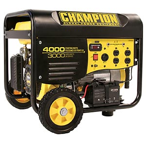

Posted: 14 Jun 2012 at 3:52pm |
Originally posted by dsmiths
Seanl, sounds like that Champion is a good all around deal, Donna and I dont usually dry camp, but I have a 5500/6875 surge Generac, but I dont think thats to practical to take with us. Be careful shrouding your gen set, the alternator and engine are air cooled, maybe you could come up with something that is circular and the top is open, that way it would dampen sound going out at ear level but keep the air flow moving, just a thought, safe travels all.  |
Thanks for the info. One of the reasons my wife and I did not want to spend lot of money on a generator was we only need it about one week a year when we go to the Nascar races and the rest of the time we camp at parks with hookups. The Generator Tent is designed with with ventilation. The top opens up and so do both ends if you need it for exhaust and air intake. also the bottom walls of the tent are 4 inches off the ground so that it will draw cooler air in from the bottom and out through the top like a chimney.

Posted: 14 Jun 2012 at 3:23pm |

Posted: 14 Jun 2012 at 2:05pm |
Originally posted by Camper Bob
Does the Champion have the inverter electronics to safely run tv's, computers, etc? That may be why they are so much cheaper. Additionally, can't easily lift 100 lbs now. That would be a major stumbling block for me. Bought the Honda, no regrets. Light, quiet, and will run sensitive electronics. Safe Travels. |
I will give you quiet and light but the part about sensitive electronics not so much. Inverter Generators are less noisy which means they will run audio and video equipment with less aritfacts but computers don't care. Computer power supplys will work with anything from 100 volts to 240 volts AC and filter it to within an inch of their lives. There is nothing more robust than a computer power supply. There is very little danger of damaging sensitive electronics only in introducing hiss to audio and snow to video. Having said that I ran my TV and Radio in the Pod and it was dead clean.
Have fun with the Honda It really was my first choice just not in the budget and any of the budget inverter generators really are junk as far as I can tell.

Posted: 14 Jun 2012 at 10:40am |
My Champion has nearly 50 hours on it (0 hours camping sadly) and starts easily, runs fine, and uses no where near as much gas as wagnert's buddy's Generator does. You can hold a conversation right next to it while running, but it is louder than a Honda. But even the Hondas shut down during quiet time in the campground. I think it is a good value. YMMV
Mine is brand new just has 5 hours of break in time on it and at 58 Db really quite for the price and as for easy starting mine has the electric start so I just push a button  .
I am getting a small tent type device made with sound deadening material put put over it to cut the sound even more and eventually I am going to get a tri fuel conversion kit for it so it will run on propane. Earlier I said that it was 3500 watts but it is only 3000 running watts and 4000 surge. More than enough for everything on the Rpod.
The Motor is a blueprint level copy of the Honda GX200 engine. I am really happy with it so far. Its only downside is the weight but I don't think that you can get 3000 watts much lighter. I could save a little by taking out the battery and using the Pod's battery to start it but I don't want to do that just yet. I also took the wheels off mine so that I can get it on a rack I put on the tongue of the trailer.
