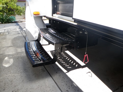

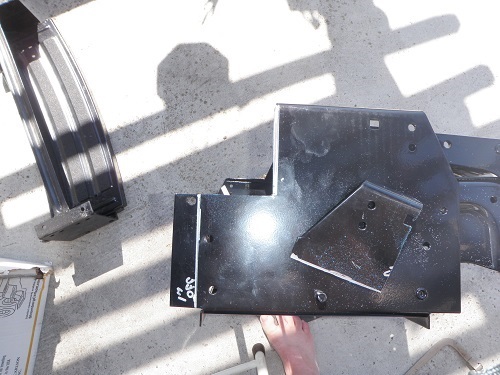

  | Mike B   Newbie
 Joined: 14 Apr 2014
 Location: San Diego Ca.
 Posts: 20
 |  Posted: 18 Aug 2014 at 11:21am |
     These are the lines I had to cut off ont
  the left side and only the 4X4 cut on the right side.
    Picture of step installed. I had to drill a hole with a safety pin to hold steps up when folded up for travel, as they do not fold all the way up do to the mods. Love getting in the Pod now. so easy.
 Thanks for all your help Techntrek.
     San Diego
R177
 Toyota TRD
 32 Ford Roadster
