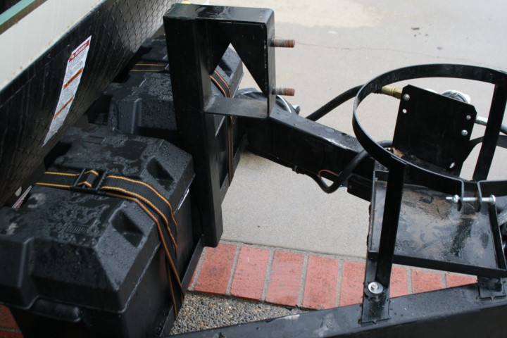

voisj
Joined: 19 Jul 2016 Location: San Luis Obispo Online Status: Offline Posts: 471 |
Posted: 28 Oct 2016 at 9:21pm |
First i did this tongue mount , and then discovered the BAL undercarriage spare tire mount and then installed a trailer tongue box up here for batteries, tire blocks jack and some tools.
