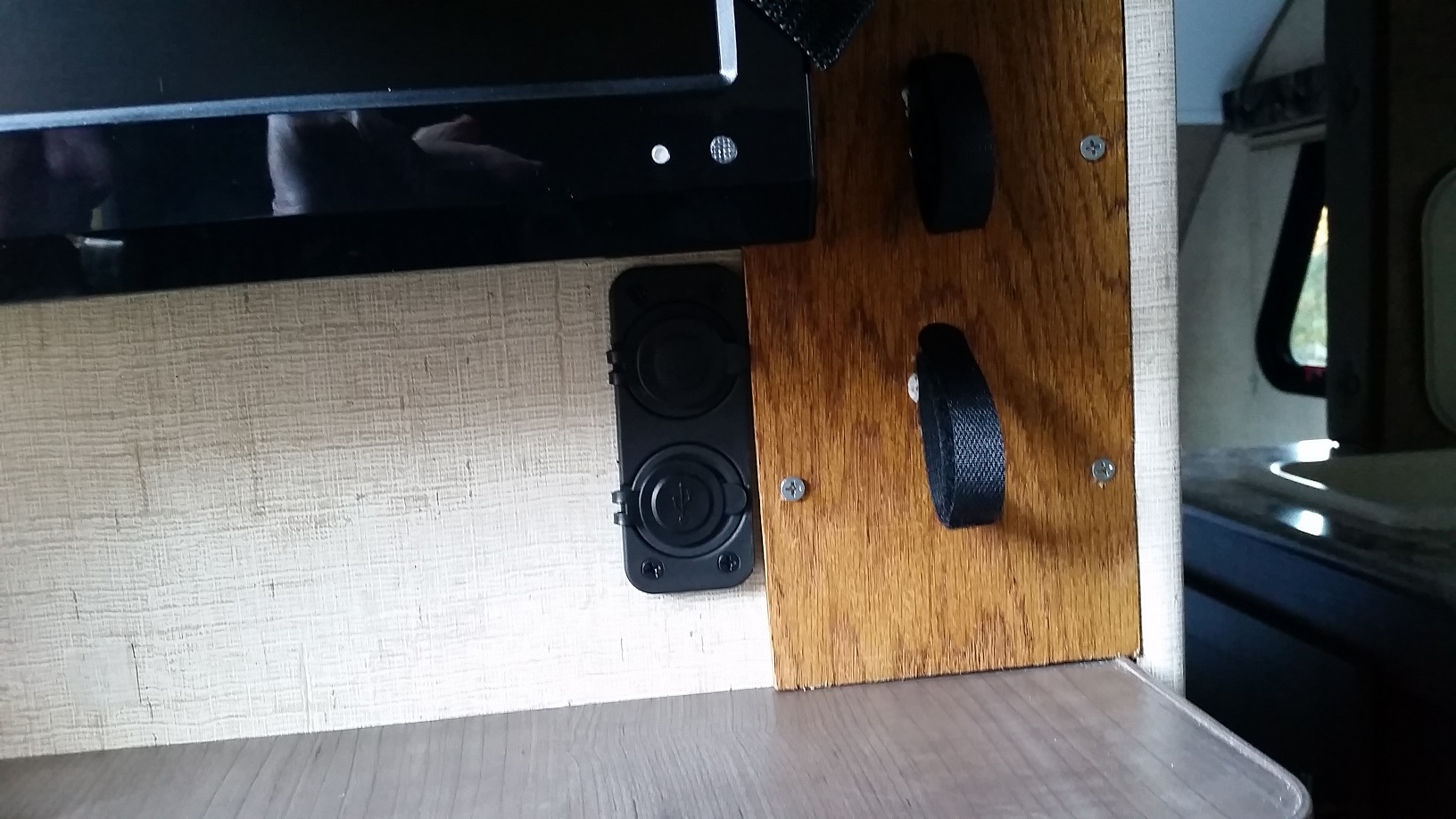

I bought the 12 volt USB receptacle from Amazon.  It's mounted below the TV on the wall left of the door (Rpod 178).  It was easy to wire to an open terminal on the power supply below it.   I also added the wood to the right to strap two cell phones to for charging, keeping them off the limited space of the counter.
Be careful to move far enough to the corner 'cause there's a stud there.  My first hole hit the stud and I had to start again.  The hole was repaired and the wood for the phone charge station hides it also.
