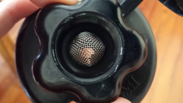

I luckily was able to get the part at a local place as it was going to be crazy expensive to ship overnight. I installed it myself and it is working great. Thanks to Roger at Couch's and you all for the great advice and knowing exactly what to do. I am leaving tomorrow for 4 days of dry camping and this was a life saver.

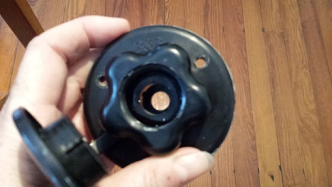

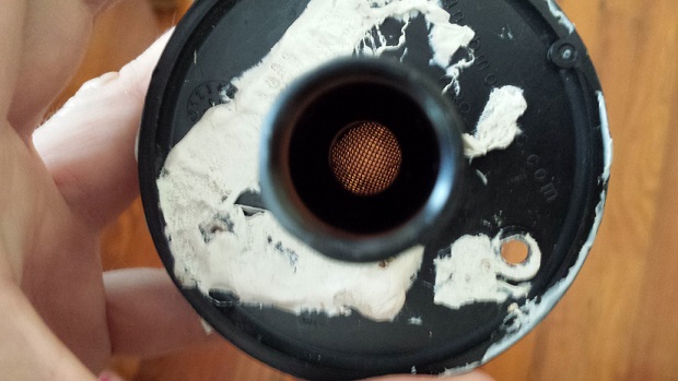

Direct Link To This Post Posted: 13 Apr 2015 at 1:04pm
Thank you so much for your advice. I took it off completely as they said I would probably have to replace it so I was checking to see if there was anything I could fix. The pieces that you are showing were not in mine, at all. So strange. Anyway, I have spoken with Roger at Couch's and he was great. He had one in stock and is sending it to me today.
Thanks again for your help.

Direct Link To This Post Posted: 13 Apr 2015 at 1:00pm
If you pry out the screen and rubber washer in the center
You should see a little plastic post push the post in several times and see if the the valve reseats.
It looks like you have taken the front piece right off. if you look in the hole in the side of the trailer you should see the one way valve. you don't have to take off the cover if you just take out the screen you can get to the valve. I am not sure how this cover seals to the valve. It looks like there is some sort of sealent.
