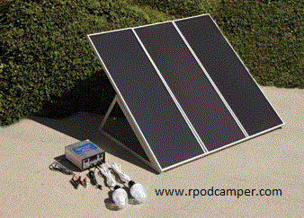

That would be 45 watts per hour in full sunlight. You can look up the "solar insolence" for your area by searching the net (one resource is below). Around me in MD its about 4.5 hours per day average, which means year-round you can count on 4.5 hours of useful sun. You'll get more during the summer when you are camping. Let's say its 6.
So 6 x 45 watts = 270 watts on a perfect summer day, no shading. At 12 volts that's about 22.5 amps. There is then some loss between the charge controller and internal battery resistance. You might get 75% into the battery (but not if its near a full charge already), so about 17 amps.

When it states that it is a 45 watt Solar Power unit; what is the output of this unit per hour or day?

I wouldn't worry about the fridge - you could run it for a month on one tank of LP, that's how little it uses. It also uses a lot of energy in electric mode, 3-8 amps per hour depending on the model (I'm not sure what the exact number is for the 'pods). At 3 amps, that's 72 amps per day, far more than a small solar setup can provide.
Posted: 19 Jan 2010 at 10:44am |
Something to keep in mind is that partial shading will prevent an entire solar panel from producing any useful output. So if one corner of the panel gets some shade, its as if the entire panel is in shade. This is due to the internal series wiring of the individual cells - when one cell is in shade it acts as a resistor and so it blocks the current from the other cells. If you often camp - or store the camper - where you can't get the panel(s) in full sun most of the day you should reconsider using solar. Often just buying a 2nd battery is the cheaper and more reliable option for a week-long trip, and/or using your tow vehicle to top off your battery every other day for a half-hour (use jumper cables and make sure to start the vehicle before attaching the camper battery).

The price is right now we just gotta see if it works for our needs. Where did you find it? For us I am thinking lights, water pump (not the water heater) plus I'd like to get the frig off LP.
