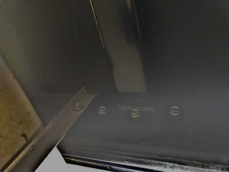

Thanks to John T, I now have a cross-brace under the floor of our RPod to prevent the problem John M. detailed. Since John T lives near me, he had a shop fabricate two tubes with end plates. Mine was sized to fit the space on our RPod. His is slightly longer. (again, let no two pods be built the same seems to apply). I cleaned it up and painted it. This morning I installed it. The shop put 5 holes in the mounting plates, but I only used 3 of them, thinking that it should be sufficient since this is to strengthen the floor, not carry the entire load.
Here are a couple of pictures:
This is a preventative measure. Our floor is still pretty good. This is to support it to hopefully prevent the problems John M. had. Ours supports the existing floor without the additional layer that the factory put on John M.'s 'Pod.

Post Options Post Options   Quote GlueGuy Quote  Post ReplyReply Direct Link To This Post Posted: 07 Nov 2020 at 9:31am
StephenH, is that the area underneath the kitchen?
Reason I ask is because that's exactly where we put our hide-a-spare, and because of the limited space, the spare tire pushes up very firmly against the floor. I'm thinking the hide-a-spare/spare tire pretty much accomplishes the same function?
Posts: 6483
Post Options Post Options   Quote StephenH Quote  Post ReplyReply Direct Link To This Post Posted: 07 Nov 2020 at 1:27pm
Yes, that is the area. I expect that the hide-a-spare will serve the purpose with the exception that it is more flexible than the brace I installed. It can bounce some, but overall, if it is tight against the bottom, it will provide support.
Post Options Post Options   Quote offgrid Quote  Post ReplyReply Direct Link To This Post Posted: 07 Nov 2020 at 3:56pm
I think anything you do to carry some of the floor load over to the frame would take care of the issue. It’s not like its grossly under designed. The tire is going to be inflated to 50-60 psi so even 5 square inches of contact area would reduce the floor load by 250-300 lbs which should be plenty.

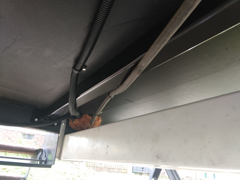

Post Options Post Options   Quote JA-Pod Quote  Post ReplyReply Direct Link To This Post Posted: 09 Nov 2020 at 9:29pm
A followup to StephenH,  Installed the bar under the floor of my 179,  although my floor was not having a sagging issue,  it always seemed a bit soft,  after installing the bar it is very solid,  it was a good investment.  Simple design, measure between the frame,  the welder subtracted 1/8 inch to allow the bar to be maneuvered into place.  there was 1/4 in difference between StephenH's bar and the one for my pod and as he said  no two pods are the same! I installed it 15 in from the grey water tank support, just to the right of the left door frame.  Thankyou John Marrucci,  although you went through a fair amount of frustration with FR,  you posting has helped a great deal.

Post Options Post Options   Quote Pod People Quote  Post ReplyReply Direct Link To This Post Posted: 09 Nov 2020 at 9:37pm
Thanks to all of you guys-I just sent my welder a design for our support. I will get it Thursday and install it in our 179.  I made mine different by adding 2 short(16")  going front to back as well.
will post after installation
Thanks for the idea and design-podders helping each other again!

Post Options Post Options   Quote StephenH Quote  Post ReplyReply Direct Link To This Post Posted: 09 Nov 2020 at 10:17pm
John,
It looks good. I also appreciate John Marucci's posting of his floor modification from Forest River. I think it is good to be proactive on this. I agree that the floor seems much more solid with the bar. I am looking forward to seeing the one you are having made Vann.
