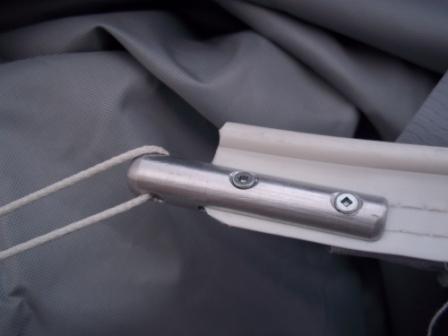

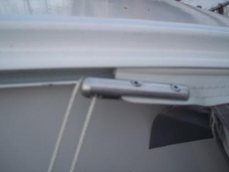

This gives you something to hold on to, and pull the dome through the track.

I want one! Did you machine the parts yourself?

Yes I did.

It is 1/2" aluminum rod, I made a slit in it on my tablesaw, put it in my drillpress to round off the ends, drilled two holes in it, than I slid it on the vinyl strip and put 2 screws in it.
