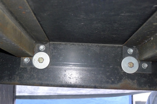

I was lucky enough to find the thread shown above before one of the tanks fell off our pod.  I knew it was going to happen for sure once I crawled under the Pod and looked at it.
Once the new tank is installed and the problem is "fixed" you will want to add bolts on each bracket through the center of the frame for each of the three tanks.  Good as new from FR will still have the tanks ready to fall off.  In addition to the replacing the screws/adding a bolt, you also may need to add shims.

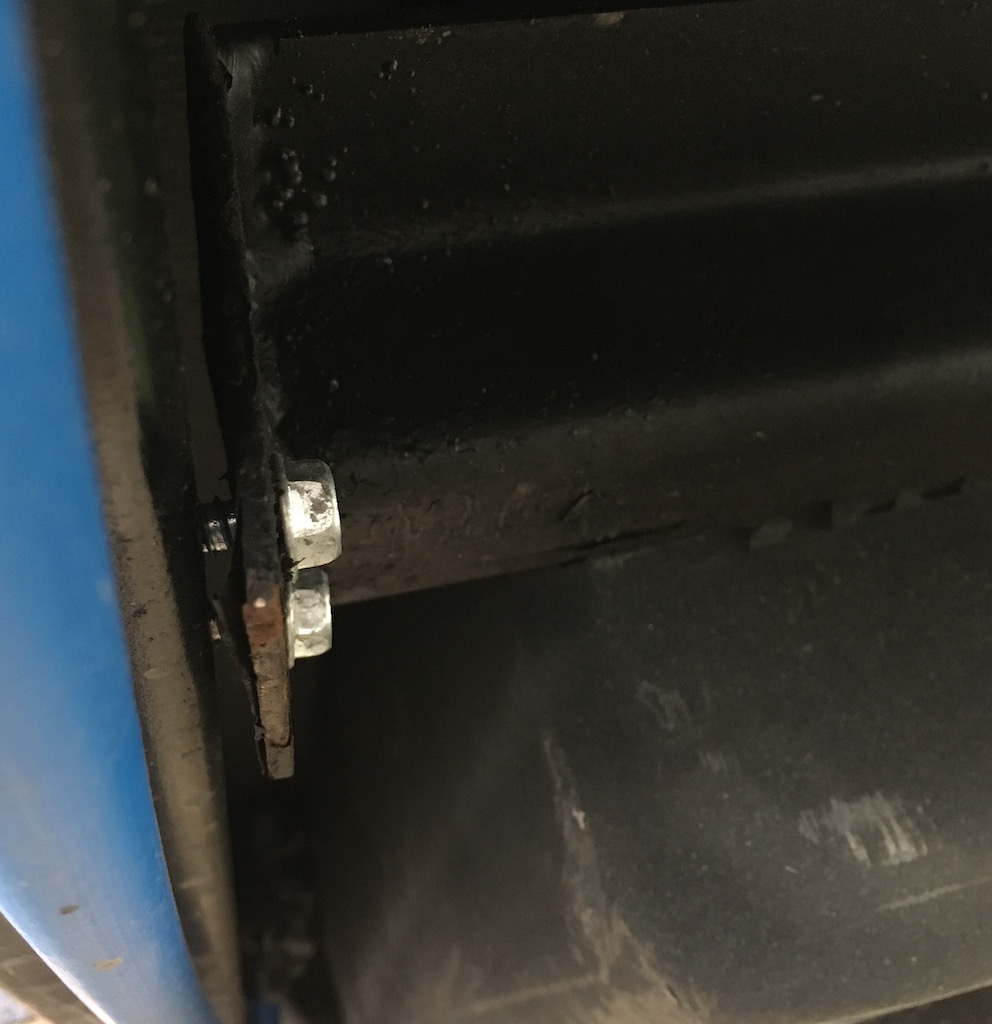

Date Posted: 14 Mar 2016 at 9:08pm
The tank brackets on mine looked OK and all seemed to fit.  After looking closer, half the screws were missing and some of the ones still present were sheared off.  The screws are very small self tapping screws....the same ones used on supporting a plastic wiring harness support.  At minimum, bigger screws are needed in all the holes.  Better yet, add one actual bolt through each bracket.  Not difficult to do. The brackets are structural components and the design relying on a few dinky screws is beyond terrible.

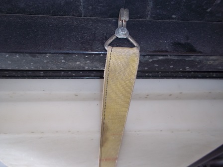

Posted By: marwayne
Date Posted: 15 Mar 2016 at 7:52pm
I put a strap under my fresh water tank, I will put a strap on the other 2 tanks.
Great idea! I will be doing the same

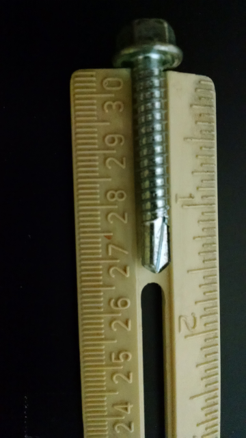

Date Posted: 16 Mar 2016 at 10:50pm
Those screws are not meant for significant load bearing. I would not trust them with anything more than holding together body or widow panels. Someone threw engineering out the window in favor of saving factory man hours. Through bolt and a few drops of Loc-Tite, that would probably last the lifetime of the RV.

You're probably correct if the screws are:
a) Present
b) Not twisted off or stripped
c) Installed without gaps between brackets and frame
These conditions are not always met, apparently. I believe #12 or #14 sheet metal screws would be adequate. I don't know what size is being used today. The worst cases are where there are gaps between the brackets and the frame. That puts a bending load on the screws, the weakest mode for a screw.

We picked up our R-Pod from the dealer today. Most of the brackets are now tight. What I think was done was to just tighten the screws. However, when we got there, the bracket on the entry door side for the fresh water tank was still not done. A technician came out and finished the job, but apparently either stripped out or sheared off one of the screws, as he then drilled another hole between the two and put a screw there. I'm not happy with that, but since I did not want to wait around longer or make yet another trip, we picked it up and I will modify that bracket to something more satisfactory.
The rest, I will monitor to ensure they are not loosening.

When I looked closer, the technician had stripped out the hole. That is why he had drilled and put a screw in between the locations for the original ones. I did not like that, so I purchased six 5/8x24x3" Stainless Steel hex-head bolts, six stainless steel washers, and six stainless steel nylock nuts. On the first bracket, I used the stripped hole to drill through the bracket and frame. On each of the others, I removed one screw and used that hole to drill through. Each got a bolt, washer, and locknut. I would say that this should be a permanent fix. The hard part is trying to drill straight. I didn't always get it perfect, but it is still better than what was in there originally.

I checked all the tanks on my 2015 179 yesterday all of the bars that secure the tanks appear to mounted properly that's flush with the frame, however none of the bolts were tight. I took one or more turns on all the bolts to snug them up, being careful not to over tighten not knowing what sort of fastener was on the other side.

Those are small self tapping screws....there is no fastener on the other side.  I put a real bolt through the center of each bracket.  Drilled a quarter inch hole through each bracket into the center of the frame member.  I recall the top is accessible to put a nut on by reaching around.

In case anyone is interested, this is the type screw used for the tanks. There were two in each bracket, both in the bottom holes. The top holes had nothing.

timpod, glad you caught it. The dealer did nothing more than take an impact driver and tighten them. I did not trust that after one of the screws stripped and he had to drill and put one between the original two locations. That is why I decided to drill and install stainless steel bolts, washers, and locknuts. I'm pretty sure now that my tanks will stay in their correct locations.

It tightened without spacers. I suspect it is from pulling the frame in to the crossmember. I don't think the crossmember stretches.
