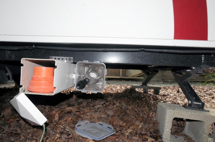

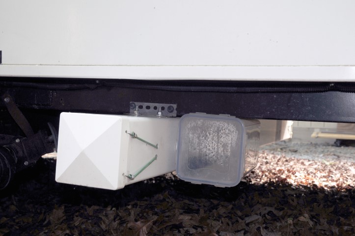

5” PVC Fence post with ends bolted to the frame –holds all
of the sewer hoses and fittings. The
clear box next to it holds the Hydroflush.

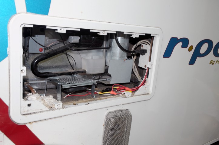

I installed 3 12 volt computer fans in the refrigerator
vent/exhaust area. The one at the bottom blows up, the middle one(not visible)
blows up under the cooling fins, and the top one blows out. They are connected to a lighted switch inside
on the microwave/refrigerator cabinet. I
also installed 2 wooded baffles(not visible)-one at the bottom and one at the
top.

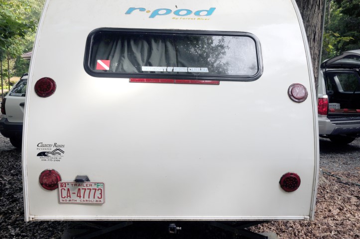

I added another set of brake/tail lights to the rear. We use a rear bike rack and I thought the
lights were marginally obstructed/visible.
I ordered the same units as originals.

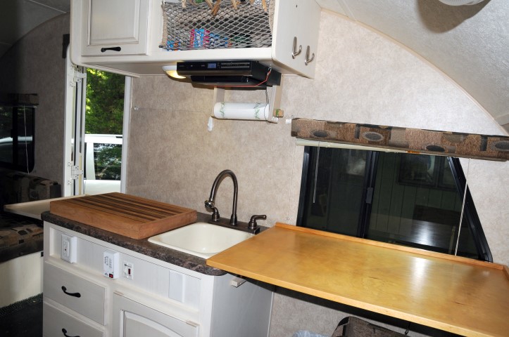

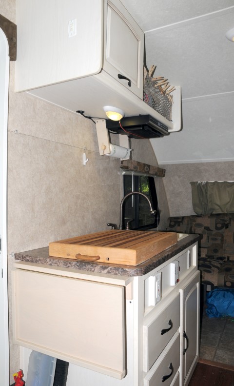

This is a folding countertop extension on the right side of
the stove/sink cabinet
This is a removable countertop extension for the left side
of the stove/sink cabinet. It attaches
to the cabinet on the left side with a simple screen door hook. On the right, it has a folding leg that rests
on the seat of the futon.

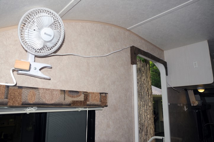

This is an electric fan. It blows toward the dinette/bed
area when needed.

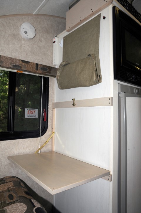

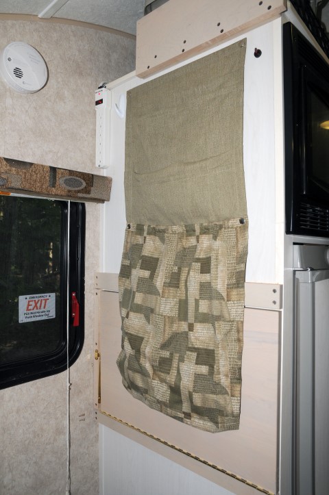

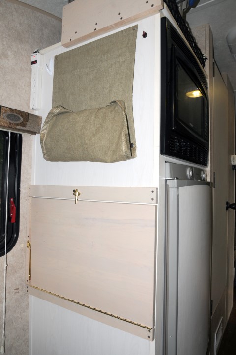

This is a folding desk top that is mounted to the side of
the refrigerator/microwave cabinet.
There is a lso a GFI outlet strip above for computers, phones and an LED
clamp-on desk lamp.

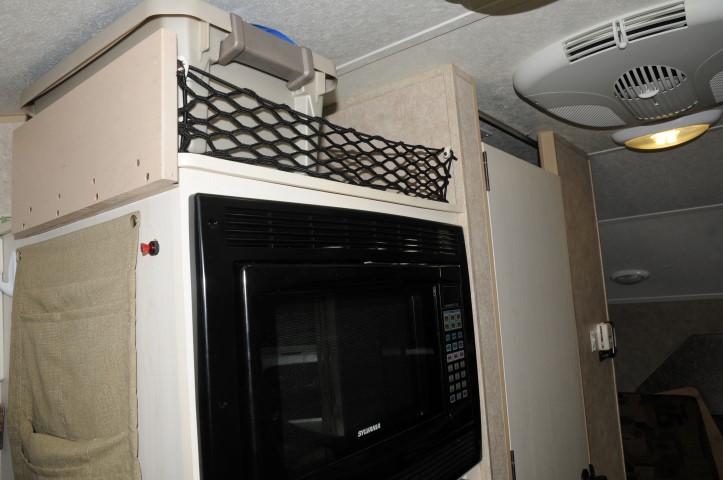

I added an end and cargo netting to the area above the
microwave. This gave us secure storage.
The red switch at the top operates the fans in the refrigerator venting bay.

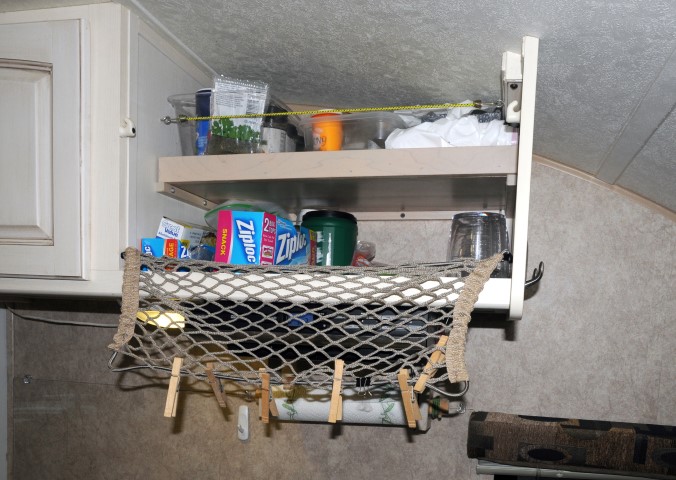

Added a second shelf and cargo netting to the cabinet above
the sink.

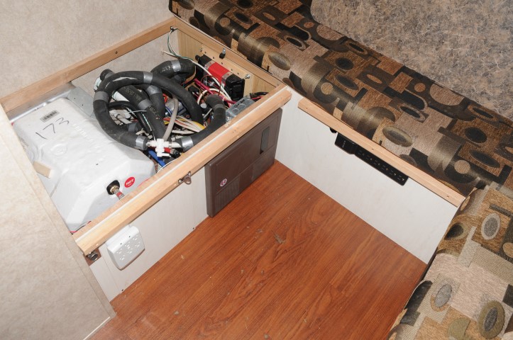

I added a 750 watt inverter(red box) and attached a black
outlet strip for use when boondocking. I
also added an additional 12 volt outlet and a 110 multi-outlet . All of the water pipes have been wrapped in
foam to suppress noise. I also mounted
the water pump on a 1” foam base for noise suppression. I also relocated the table locator pin to the
opposite side to avoid any more shin cuts and bruises.
