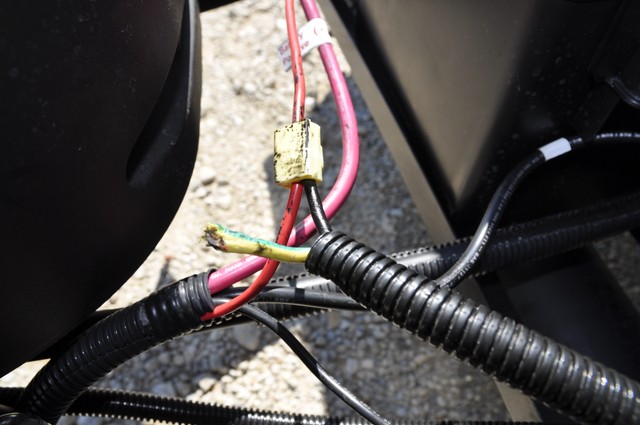

Really poor work done by that dealership!

Well, I know this isn't exactly your problem. Only thing I can say is that I feel your pain!

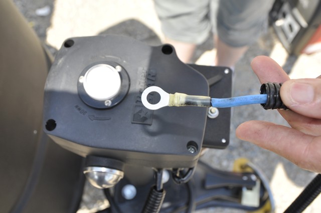

I've rewired or am in the process of rewiring the battery connections. As an example, on the tongue jack I've installed a marine grade connector that has shrink tubing rather than the stupid vinyl shields.

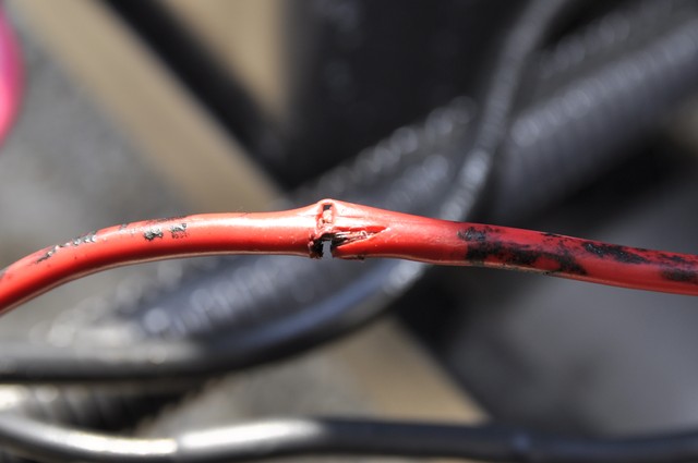

I was disappointed in the condition of our trailer on delivery. I had asked the dealer to install an electric tongue jack. When I picked up the trailer there was a ball of wiring wrapped in black tape. When I got home, I removed the black tape and found this mess (pictures).
