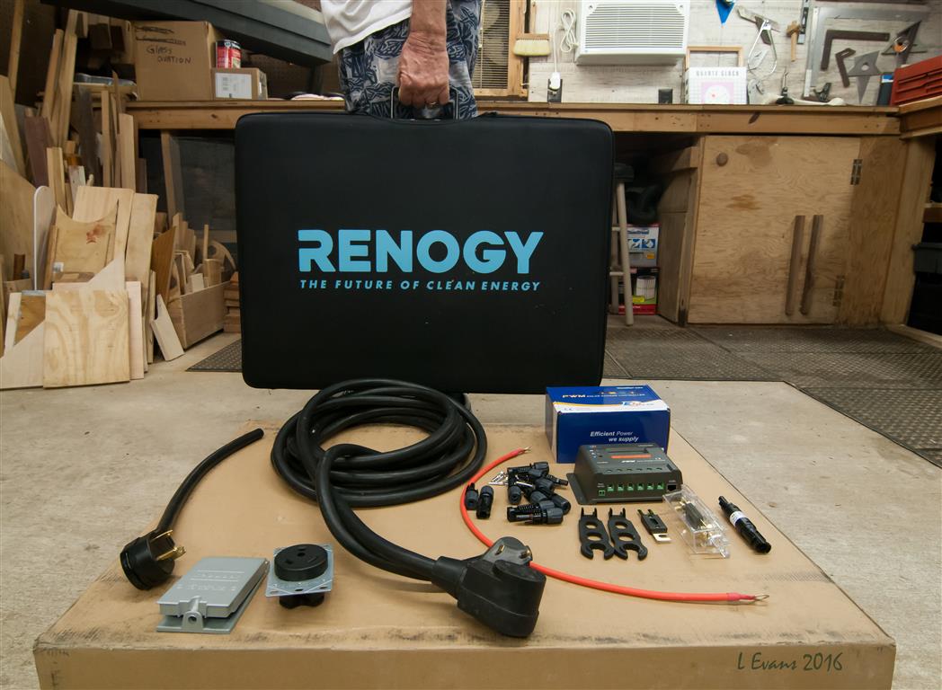

I made up a parts list and ordered what we needed.  Overall, this project cost less than $475-about ½ the cost of a Honda generator.  Here is a list of the parts I bought from Renogy
100watt 12 volt Monocrystalline Foladable Solar Suitcase w/o Solar Charge Controller
Renogy View Star 20 amp PWM Solar Charge Controller
20amp ANL fuse set w/ extra fuse
MC4 assembly tools (2 specialized wrenches)
MC4 set (of 5 waterproof connectors)
10amp inline fuse module
Renogy does not charge taxes and shipping is free, plus they gave me 10% off for their Memorial Day Sale.
I bought these parts from an online RV parts supplier:
30amp female receptacle and cover
18” male 30amp pigtail
My total cost was under $475. I spent $396.93 with Renogy, $43.56 with an online RV supplier, $21.67 at Lowe’s for 10 gauge wire and assorted electrical parts and $5.85 at a local automotive store for 12 volt electrical connectors and battery cable.  I had miscellaneous screws and hardware on hand. I spent a total of about 6 hours wiring and installing all of the parts and pieces.   I am happy to report that everything worked the first time.  I expect to get 3-5amps at 13-14.2 volts in full sun.  That should replenish our batteries daily if we have good weather and be conservative in using electricity.

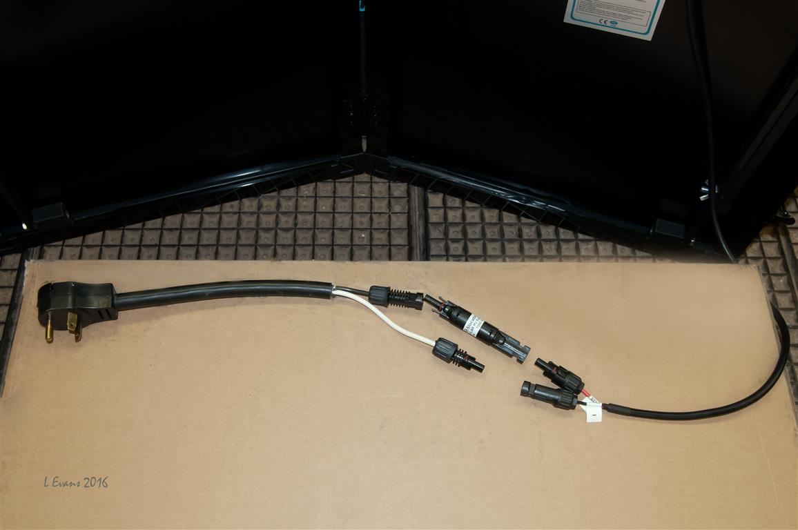

Wiring the solar panels to the Charge Controller requires waterproof electrical connectors.  The solar panels come with 18” lead wires permanently connected to the solar panels and outfitted with built-in snap-connectors (MC4) at the other end.  MC 4 connectors are a 2-part (male/female) snap system for waterproof electrical connections.
I purchased a kit of 5 MC4 connectors and the 2 proprietary wrenches required for assembly/disassembly. There are several videos on the Renogy site and You Tube that show you that assembling and connecting the MC4 parts is simple, reversible and effective using the proprietary wrenches.
The next step is to attach the male plug to the solar panels.  I assembled the MC4 connectors on the end of the male pigtail leads. An in-line, 10-amp PV solar fuse module is required (on the positive wire) between the solar panel and the Charge Controller.  I attached this fuse between the solar panel and male pigtail plug end.
Note: This system does not need a ground of any type. Thus, we use only the hot and neutral wires and not the ground wire in the pigtail.
So finally, I was able to plug the solar panel’s male plug into the female end of my 25-foot RV extension cord.

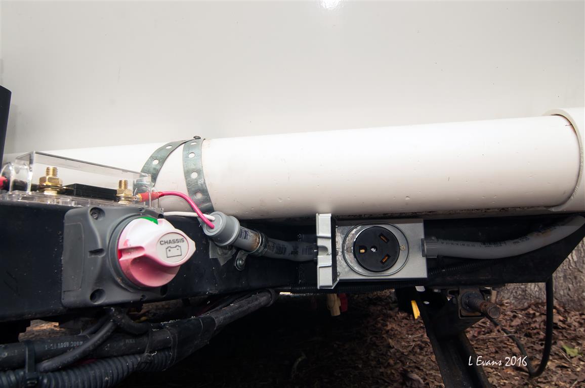

The next step was to mount the female 30 amp receptacle in a waterproof exterior box on the main frame under the front of the R Pod. Once the receptacle is installed, the male end of the extension cord will plug into it.

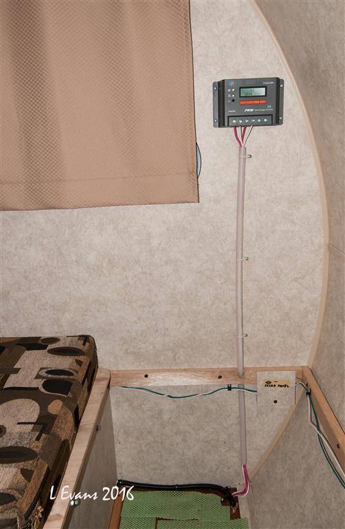

Now, I have to get the wires from the receptacle to the Charge Controller. The Charge Controller is located inside the pod as close to the batteries as possible. The 10 gauge wires from the female receptacle run in ½” PVC conduit to a hole drilled in the floor.  I used a heat gun to customize the shape of the conduit.  The wires come into the pod inside the front storage area under the dinette seat.   I used PEX plumbing pipe as a conduit from the floor up to the Charge Controller.  I connected the wires from the 30 amp receptacle to the solar panel input slots (positive and negative) on the Charge Controller.  That completes the power input side of the project.  Thus the entire sequence of power input consists of the solar panel with an inline 10 amp fuse plugged to the 25’ power cord which is plugged to the 30 amp receptacle which is hard-wired to the Charge Controller.

I chose the PWM Charge Controller over an MPPT Charge Controller for our solar system.  We have only one portable solar panel and it is under 200 Watts.  So, we don’t need the considerably more expensive, higher capacity, higher efficiency MPPT Charge Controller.

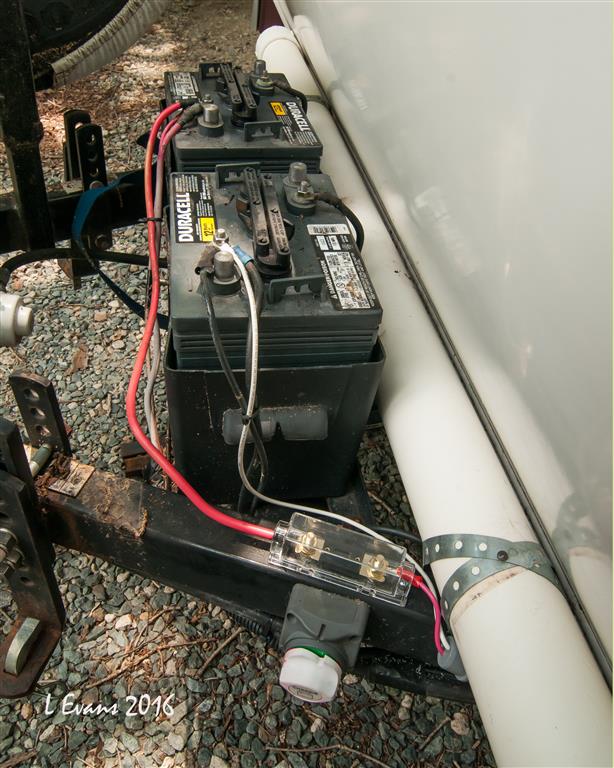

I connected the Charge Controller with 10 gauge output wires to the positive and negative terminals of the battery.  I routed the wires from the Charge Controller down the PEX conduit, through the hole in the floor, through a short piece of PVC conduit, through the waterproof receptacle box, through another piece of PVC conduit and out the conduit end cap.  The positive wire goes to a 20 amp ANL fuse block that I mounted on top of the Pod’s A Frame. I used a standard automotive battery cable to connect the fuse directly to the positive battery terminal.  I used 10 gauge wire to connect the negative line directly from the Charge Controller to the negative battery terminal.
Charge Controller
The Charge Controller has a small LCD screen with a number of menus, information and read-outs.  It does not require any special programming; it is fully functional out of the box.  However, the Charge Controller can be highly customized.  The owners’ manual covers what you need to know.

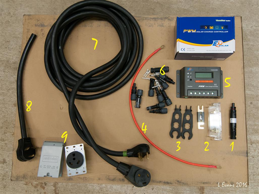

These are the basic materials needed for our installation
1.      10 amp PV solar inline fuse module
2.      20 amp ANL fuse unit
3.      MC4 wrenches
4.      24” battery cable
5.      Viewstar 20 amp Charge Controller
6.      MC4 connectors
7.      25’ 30amp RV power cord
8.      18” male 30amp pigtail
9.      30amp female receptacle and waterproof cover
Male pigtail:  The positive wire has a female MC4 end connected to the male MC4 of the 10 amp fuse.  The female end of the 10 amp fuse is connected to the male MC4 end of the solar panel positive lead wire.  The neutral (white) pigtail wire has a male MC4 which plugs into the female MC4 of the solar panel negative lead wire.
Note: This system does not need a ground of any type. Thus, we use only the hot and neutral wires and not the ground wire in the pigtail.  Cut the green wire off of the pigtail.
The completed connection between the Solar panel and the male plug

30 amp receptacle mounted on front frame. ½” PVC conduit with positive/negative output wires from Charge Controller
Charge Controller mounted on wall, PEX plumbing pipe used for conduit
Dual 6v Duracell batteries wired in series (230 amp hours combined) and the 20 amp ANL fuse module

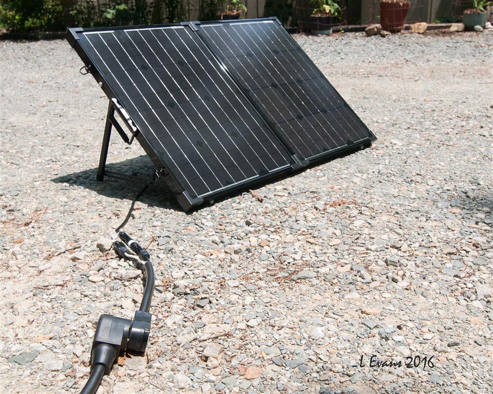

Panels are max distance from pod,
Panels are in the sun
Pod is in the shade
We now have solar power to recharge the Pod's batteries!!
