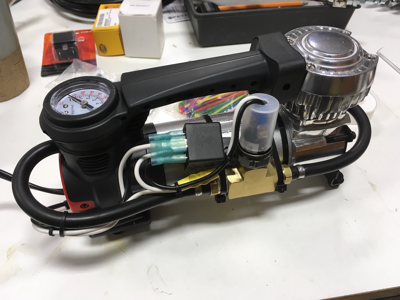

My last TV had an air compressor built in and I found it extremely useful. On the new vehicle I was thinking about building one in, but decided on a portable to start out with. A Viair 88P. The main problem I have with small portable compressors is that they're on or off. No automatic shutoff, which I find a pain to use.. especially if you're extending the hose some ways from the compressor itself.
So for the mod... I added a pressure switch, relay and a quick connect to my Viair 88P to give it an automatic on/off. I ordered an air horn pressure switch with a large dead band (85 psi on, 105 off), made for filling up small pressure tanks, and picked up a relay, 1/4" T junction and associated fittings locally.  Now I can connect up using a standard pressure hose with quick-connect, use regular air fittings, and simply turn the compressor on and do my work. The compressor turns off automatically when pressure in the hose reaches 105, and back on again when I start using it.
I didn't keep track of all the costs, but not including the compressor... the pressure switch can be had for less than $10 if you want to go cheap, $5 for a relay, and $5-6 for the fittings?
The compressor doesn't put out much air, 1.5 cfm I think... so I'm not going to be using it for air-tools... but I find the automatic on/off much more convenient.

@techntrek... there are a lot of options on the low end, but they don't put out much air. All the small compressors I've seen are way less than 1 cfm and have very short duty cycles. Even 1.5 is not a whole lot, but I wanted more air and a longer duty cycle. More of a "mid size" compressor. In that range I couldn't find anything with automatic shut-off, but maybe they're out there. What did you get?
