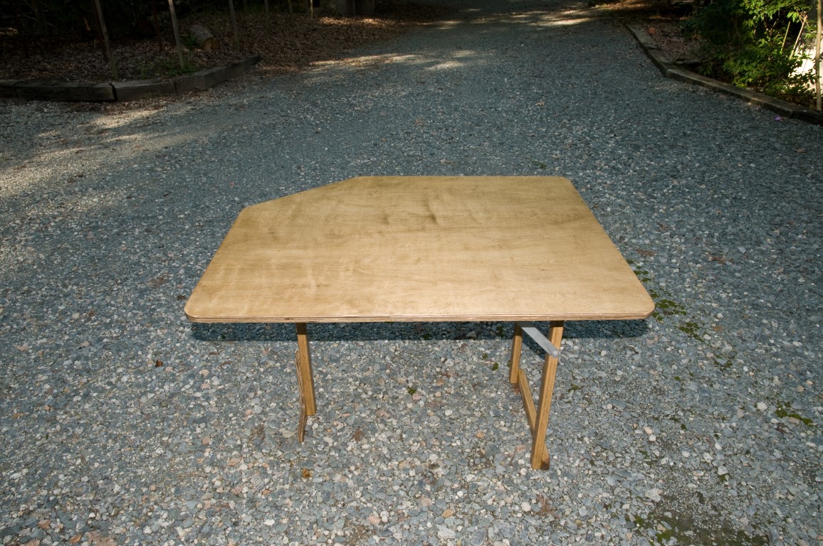

I made a freestanding table that can be moved or rotated as needed. We sometimes use it in the tent room also.

Do t know why it turned upside down

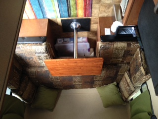

I replaced the table in my 179 with a similar table.  I screwed the base into a piece of 3/4 plywood the same size as the top.  That way we can scoot the table around or even take it apart for travel by laying it on the bed.  I made the top rectangular so we can use different seating positions, or slide it out of the way.  Much handier than a fixed table.  One just has to learn not to lean on the table when getting up.

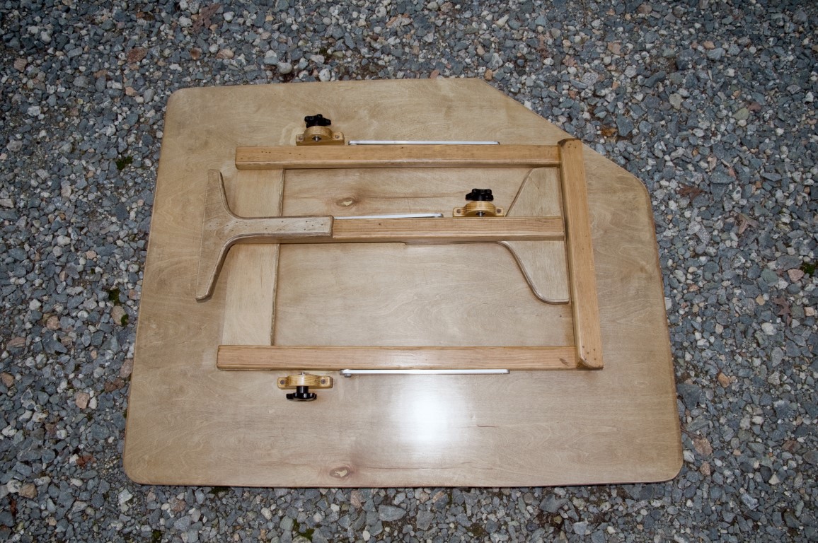

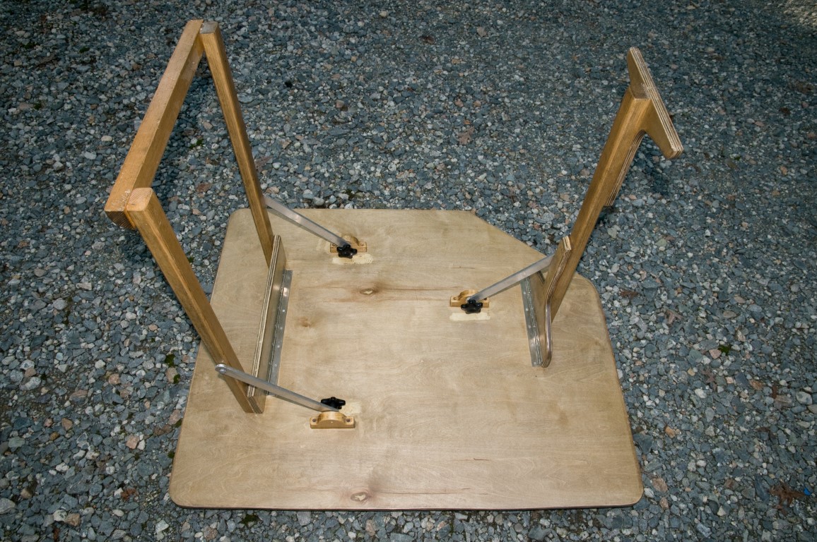

We also built a new table for our 173.  We don't use the dinette area for sleeping, so the table didn't have to be the same size in order to fit between the benches and make the bed platform.  It is made from 3/4" cabinet grade(10 ply) birch plywood.  the finish is 10 coats of table varnish.  It folds flat for traveling and is very sturdy.
