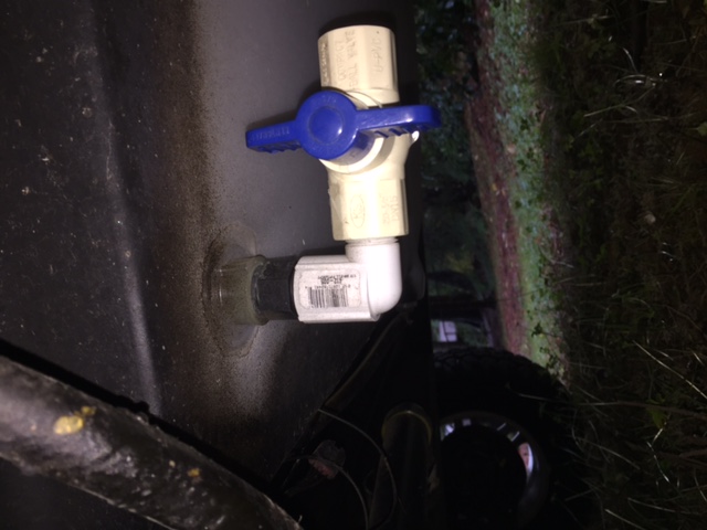

ah, found the drain. there was a modification done with a valve and I wasn't sure that was it, but it was, so it's draining now!
It sounds like a very convenient modification, and it may never be a problem, but if it sticks down further than just a cap on the pipe, it's something that could get scraped off going over a speed bump, for example.  You could end up with no water when you need it and no easy way to fill the tank.  The tank itself could even be damaged if the valve is ripped off.  Of course I can't see it from here, and you might be fine, but with just a screw-cap on the drain, you can take it off and put it back on by hand, or with a pair of pliers at the most, so the added convenience of a valve is probably of little value.
TT
2010 176
FJ Cruiser
Direct Link To This Post Posted: 02 Nov 2015 at 3:20pm
They do have an HRE, so the drain is way farther from the road then ours...

Direct Link To This Post Posted: 02 Nov 2015 at 3:26pm
I'll post a picture next time I go outside.

Direct Link To This Post Posted: 02 Nov 2015 at 5:44pm
Here is a photo (it uploaded sideways for some reason)

It's good the valve is turned sideways like it is.  It looks like it might be okay, but, like I said, it's awful easy to just unscrew the cap.
